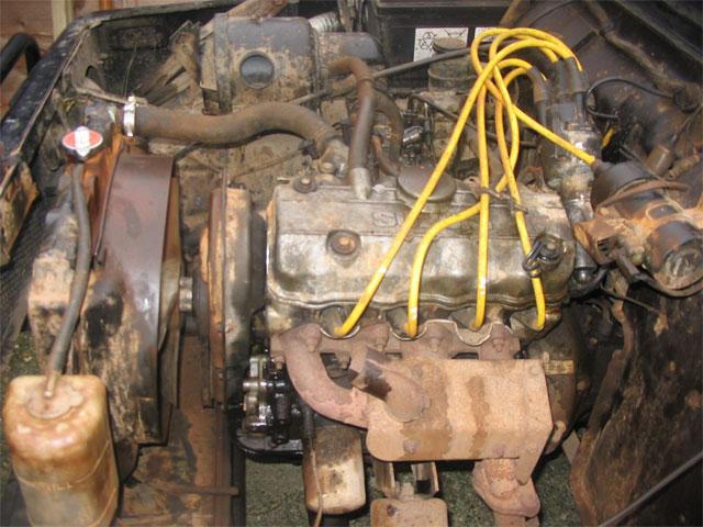

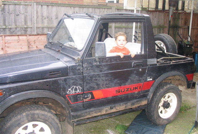

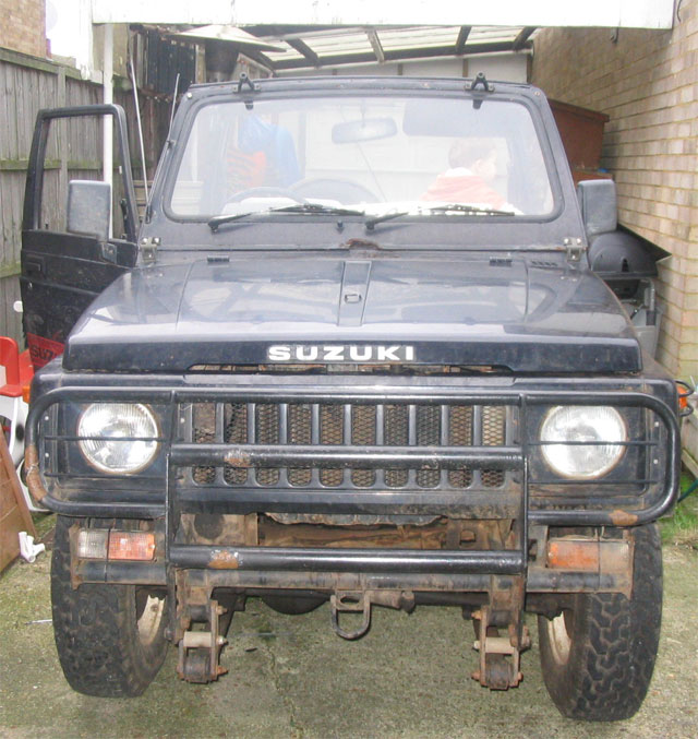

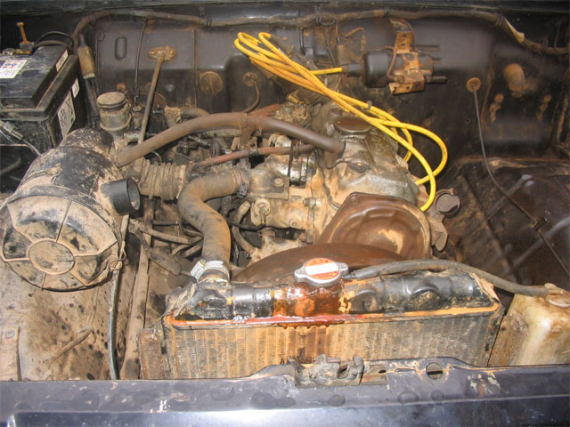

            HERE ARE THE BEFORE Pictures !
            The After pictures will probably be in a few months !

              Bit of advise regarding the rad . Try and fit the 413 rad if you can get one , or the biggest rad you can fit . The 410 rads are to small and cook the engine to quick . If using purely for off road remove the centre of the thermostat and it will run for longer before overheating with a blocked up rad . Don't remove the thermostat completly as this will allow the waterpump to cavitate and not move any coolant round making the engine overheat quicker .
              If purely for off road then rear mount the rad like most do , end of problem then .

                  Mine looked like that under the bonnet when I got it. Never been off roaded before then?? At least yours is a soft top, so you dont have to get creative with the angle grinder.

                    Bet you're gonna have fun with this new toy. Looks like your nippa is keen to get 'in' on the action too!!
