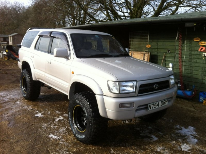

I'm due new tyres. I could find some modular wheels and 33x12.5s but I'm not too keen on doing the body lift. (2" sus already done) or I could just stick 30mm spacers on there and have a lot fewer problems. Thoughts? Examples z?
Photo request! 3rd gen on 33s or 30mm spacers?

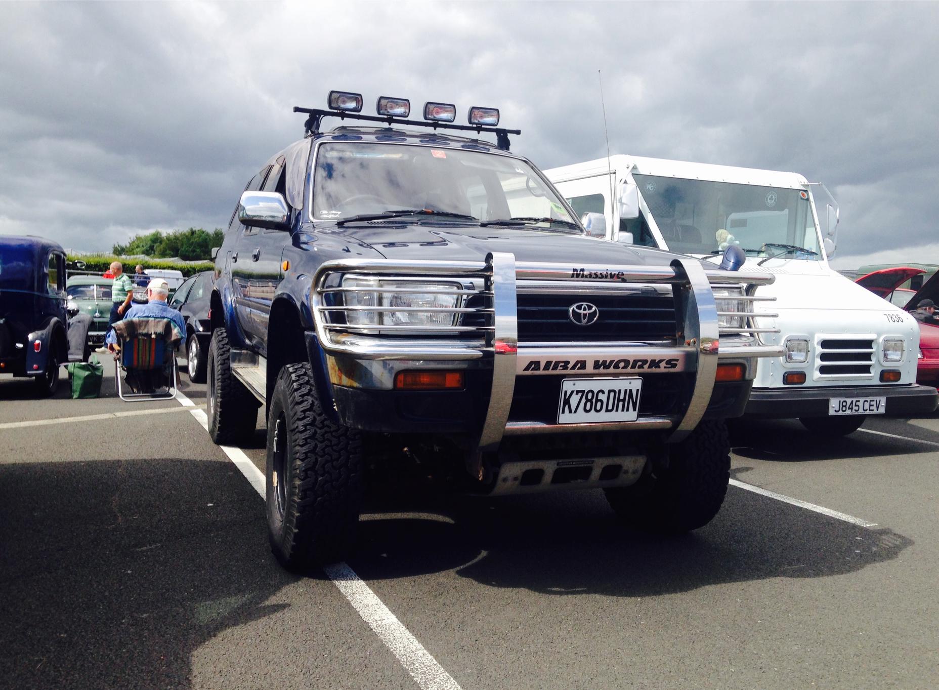

 That's also a lovely truck, can you give me more detail on the wheel/tyre setup and any problems with it (more than is in your profile)

 As for my surf, it's a 1993 2nd gen 2.4 auto. Currently on its second engine ( new cylinder head and second hand block ) after the head cracked a while ago and I couldn't afford to swap a V8 in its place.
 It has a 4 inch body lift, leaving the suspension at standard height means that even though it's so high I can still throw it into corners as it doesn't effect the centre of gravity as much as a suspension lift would.
 Wheels are weller 8 spoke, think they're 7x15 but might be 8x15 and the tyres are 31/10.50/15. No problems with them at all.
 The surf itself is slowly dieing though, I'm about to start some surgery on it, replacing the turbo, exhaust manifold, fuel lines, ARB bushes and drop links, both bumpers and the radio. As well as adding more lights and a pair of rear light guards that match the bull bar

 I've had those wheels and that sized tyre on for about 5 years now.
 It is a bit of an attention whore, it makes a bit of a din since the V8 swap, and the plate sticks out a bit. Touch wood, so far I've not had a problem.
 I don't actually know what the offset is, but its very negative... on all honesty, a little more that I'd like.. I have to run so much lift not to have the fronts catch on the back of the wheel arches on mid lock, but I loved the wheels, and a set of 5 is pretty rare, so I went for it.Last edited by Karma Supra; 27 October 2016, 02:21.More Lift.
