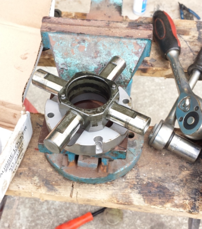

rear one now sorted will post pics shortly when i do the front one!
These are what I fitted to the front & rear of my 70 Series Land Cruiser. There are Detroit Truetrac and I fitted one to the front & one to the rear. They give excellent traction off road & cross axle grip.
