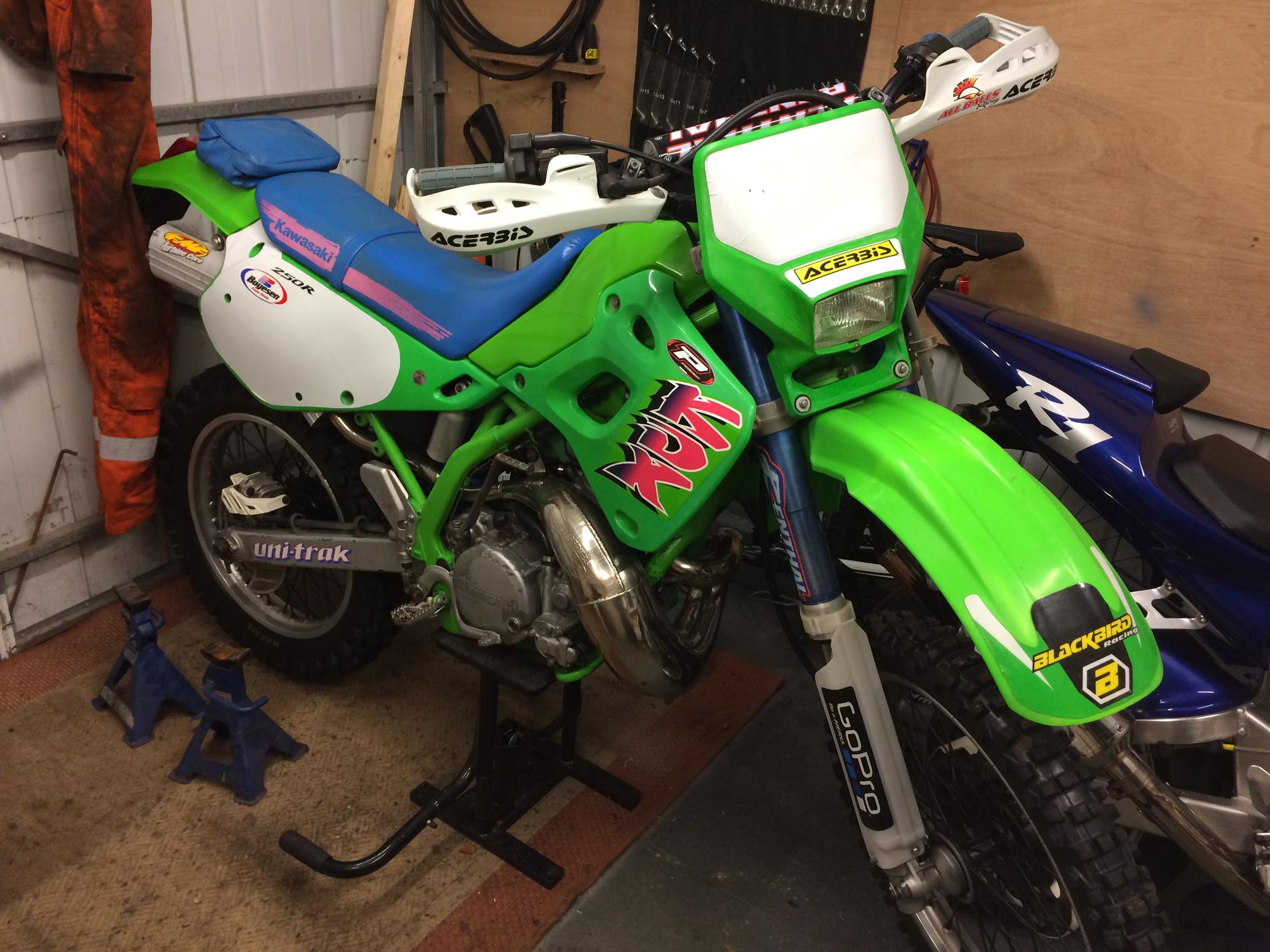

ha ha yea the bug is catching! , but nice to have something else to mess around with ,just finished my other little toy so now need something else to spend time and money on lol but don't tell the misses !Originally posted by surfenstein View PostLol cheers, yep thats how the bug starts off, a small lift, new shocks, then springs, then tyres, then .........Go Hard Or Go Home
