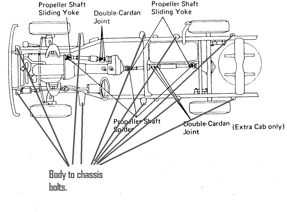

Im sure the question was answered for meny times by now but there is always one...ha.
Ive got one and half inch kit to fit on 3 ltr td auto 2nd gen surf.
Ive seen few ...well lots of post about 2 inch lifts.
As far as ive learn;
1...there is 3 bolts in the cab,one on front and one on the back (each side)
2...I don't need to loose screws for radiator in 3.0 td engines
3...simply lift each side and place the blocks in
....do I miss anything?
thanks guys
