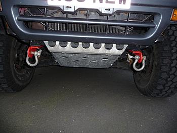

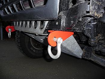

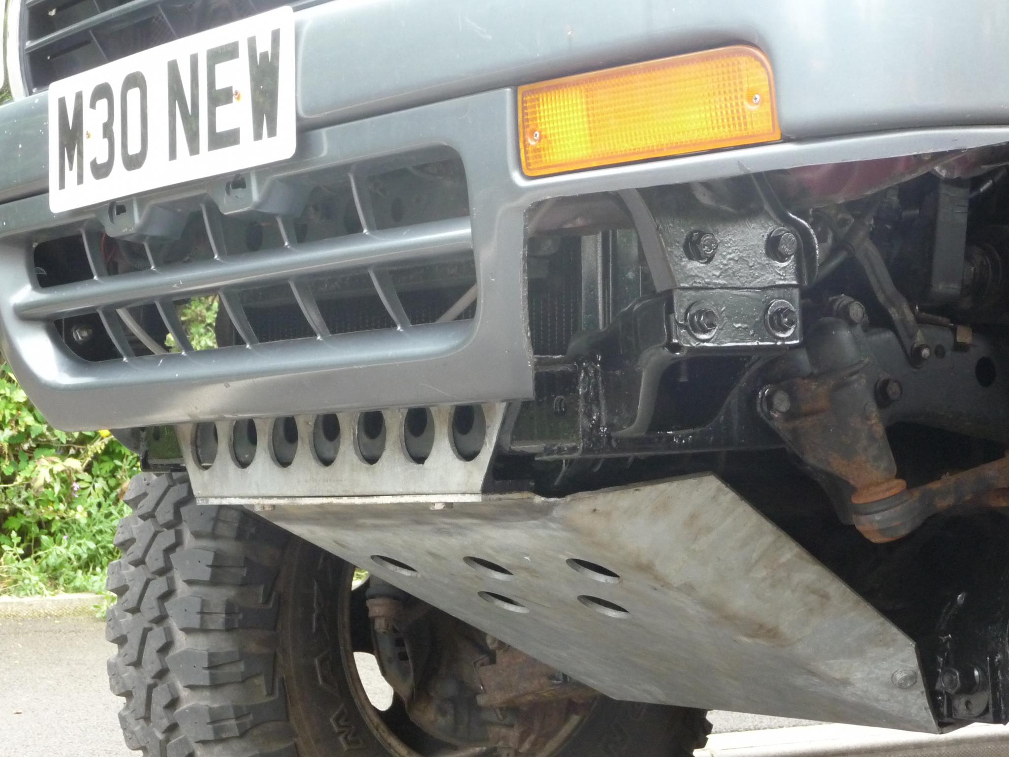

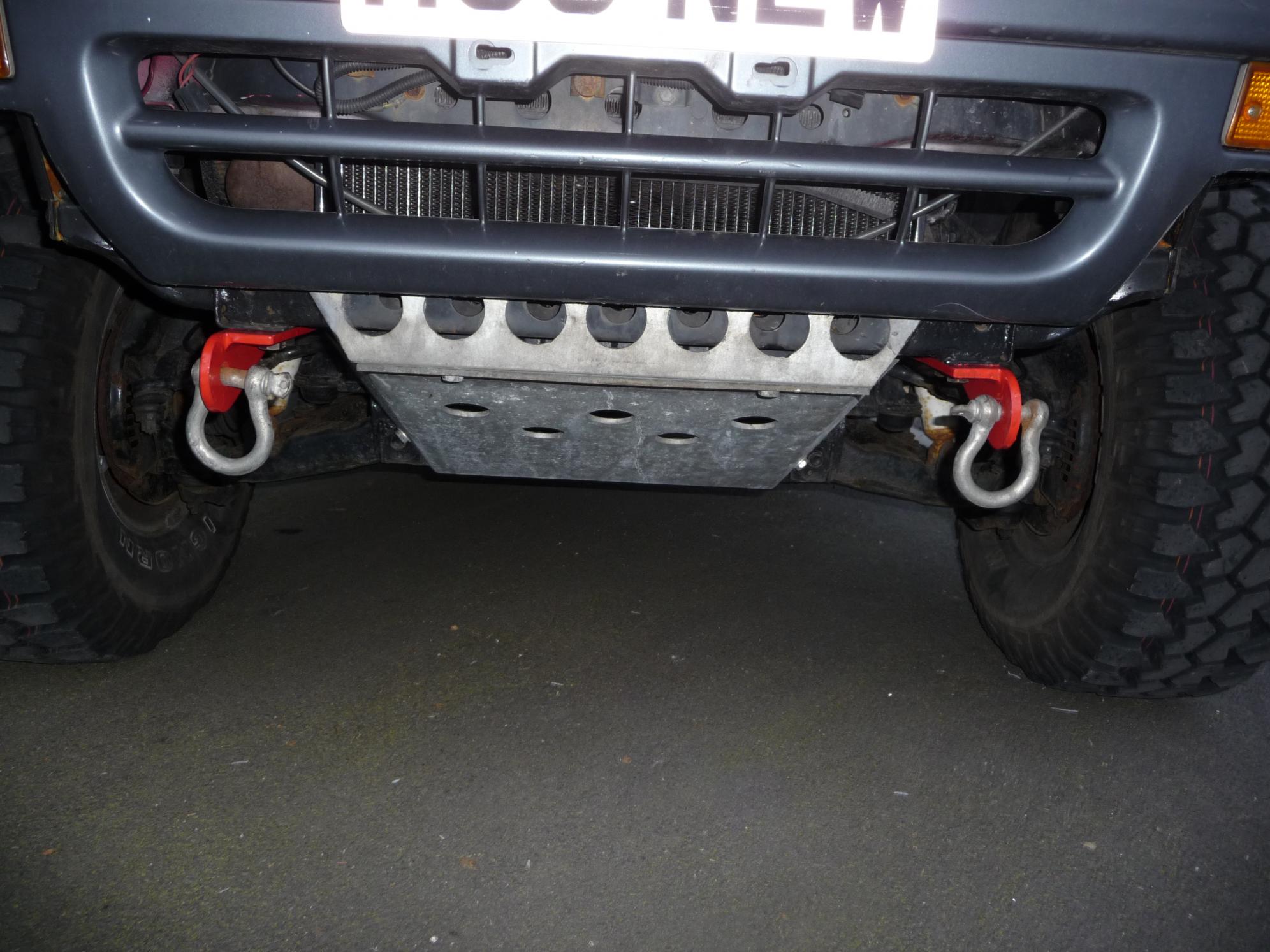

        Whats the details on your bash plate Mick ? (I need to make one for my truck..)
        • #19
          Hey Rob. I took the original design from one posted on the Aussie site and modified it a little. A mate with a fab shop cut, bent, drilled and galvanised it for me. It's made from 6mm mild steel plate, and it weighs a flippin ton! When I came to fit it, it wouldn't go straight on. The design is for a 2.4 with a shorter radiator. Mine's a 3.0, so I had to design a spacer using "U" channel, Drilled and cut at 45 degrees at the ends. Managed to cobble it all together in the end. I'll post some close ups if you like.
          " Time wounds all heels ".
          • #20
            Thanks Mick.
            I've just found the plans.
            6mm - I'm not suprised it weighs a ton !
            I was thinking of something similar to the stock one but using rectangular box section for a pair of rails, with 3mm plate. (Easier for me to work with)
            Rob.
            • #21
              Hey Rob. Is this what you were looking for? There's a couple more pics too.
              • #22
                Thanks Mick - that 1st pic is the drawing I have.
                You have a bodylift so your rad drops down 2" less than my rad ! (unless you did the rad drop ? )
                I'll look into ways to mount the bashplate a lot lower than you have ..
                Rob.
