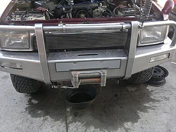

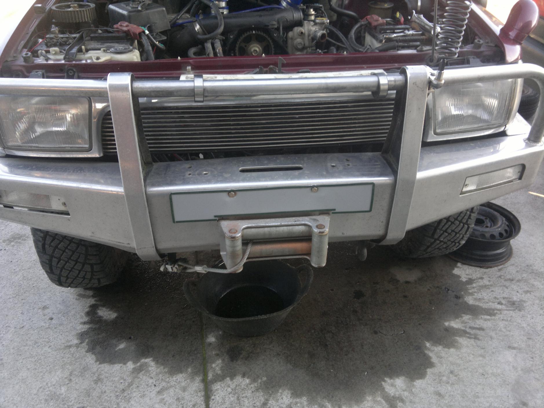

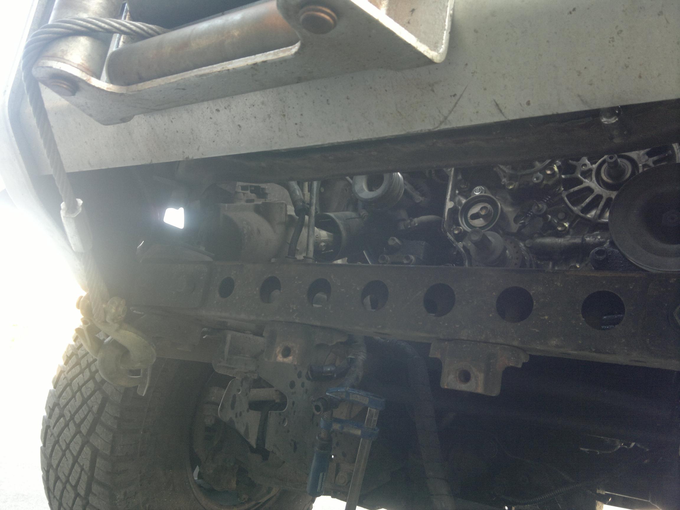

    Hi guys and girls,Iv just bought this bumper,my question is, can anyone identify it for me,(im thinking its a JDM,but not sure) but my main question is,how do I go about moding it to accept the 2" body lift,and do i need to fab up a cradle for the winch,as there is no tray inside the bumper to take a winch like the ARB type?
    cheers Alan

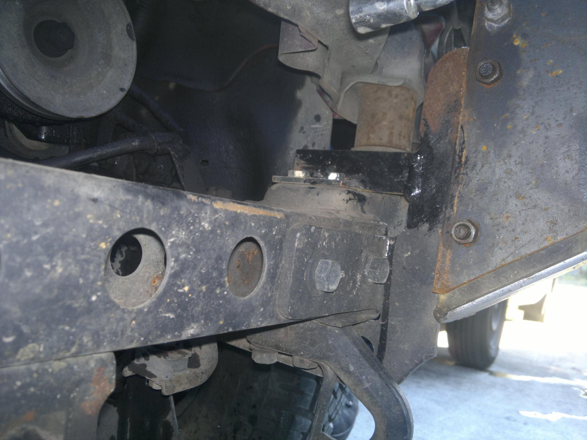

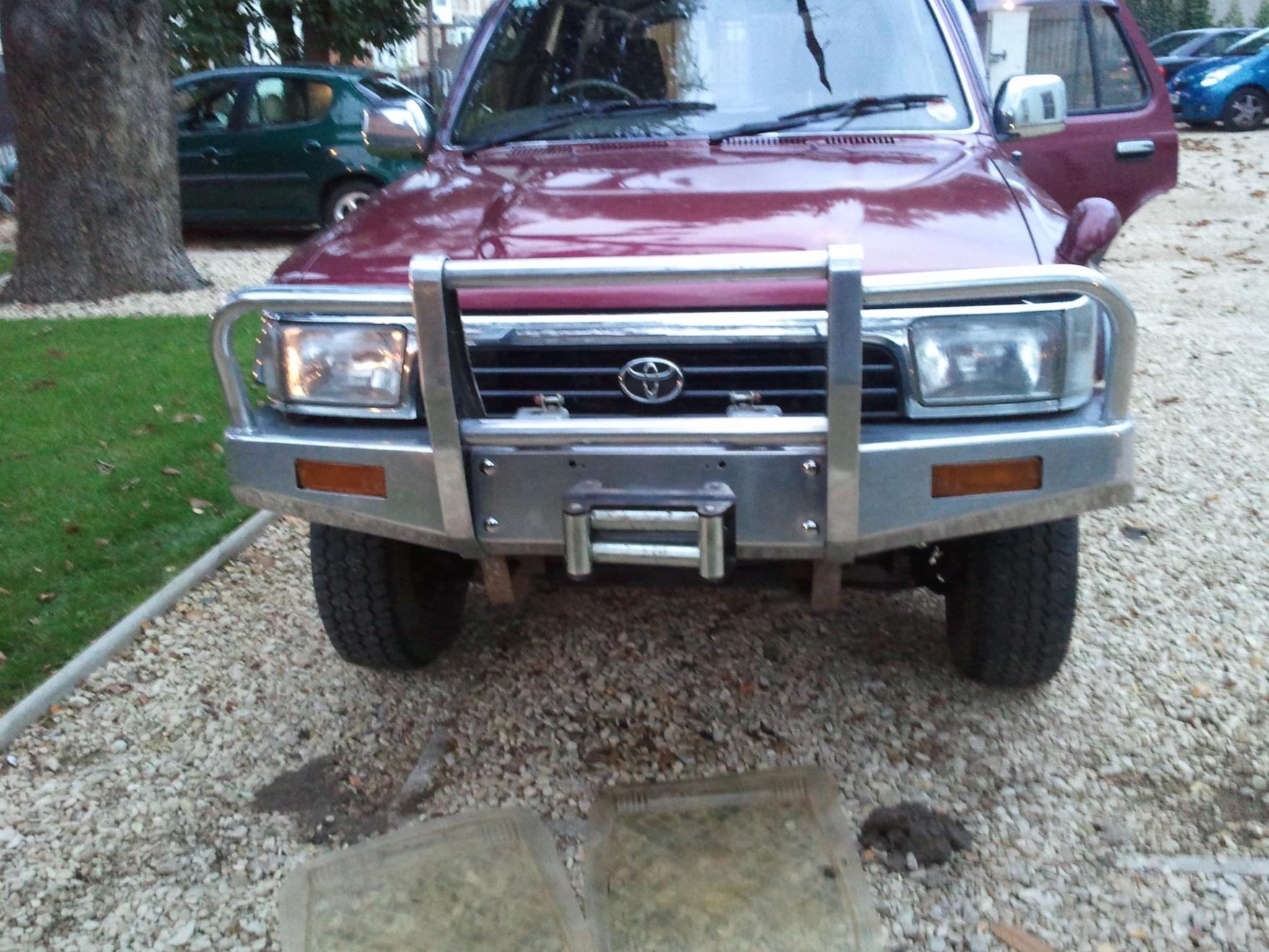

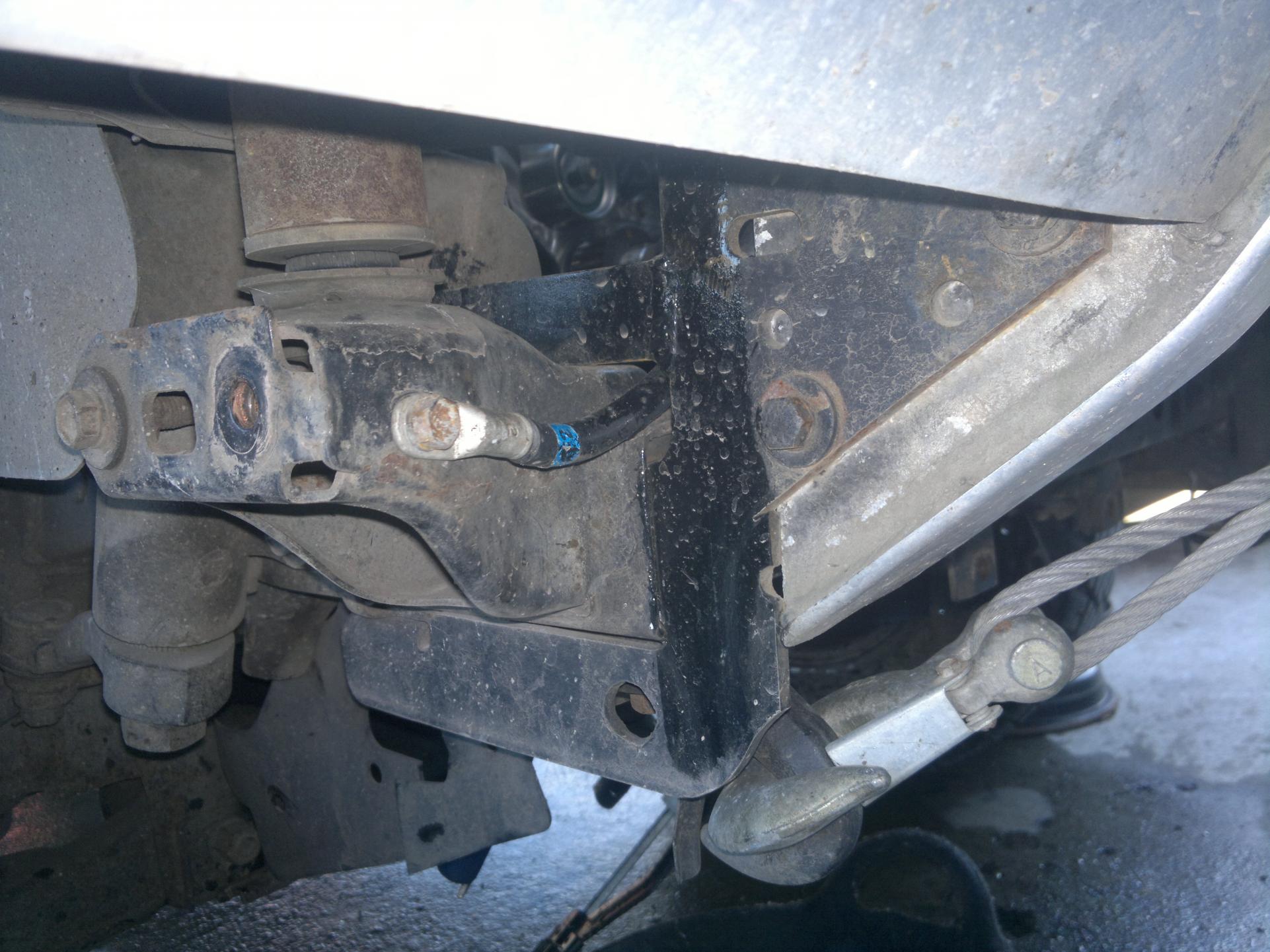

    got the body lift done and winch fitted on a very similar winch bumper
    http://www.hiluxsurf.co.uk/attachmen...8&d=1317414803
    i will take new pics tomorrow that might help.
      brill thank you mate,that would be fantastic
      cheers alan

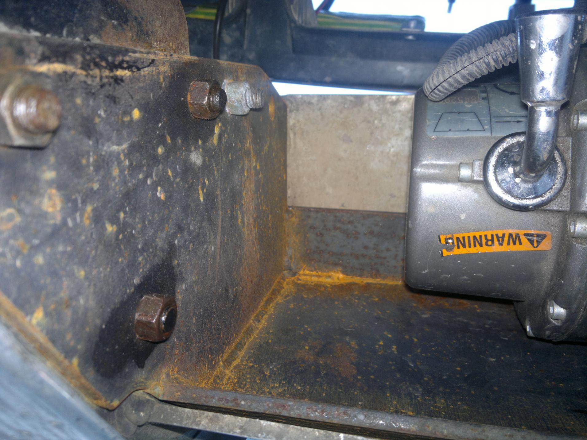

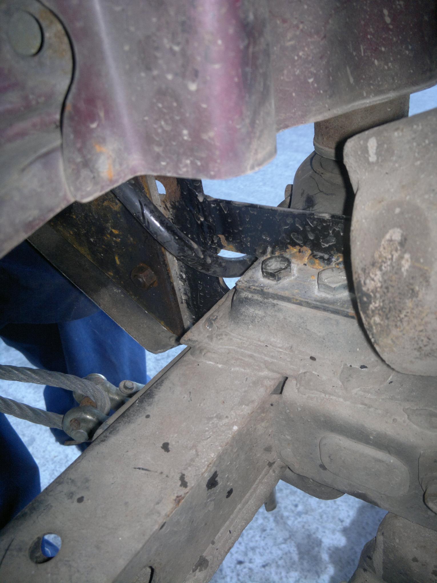

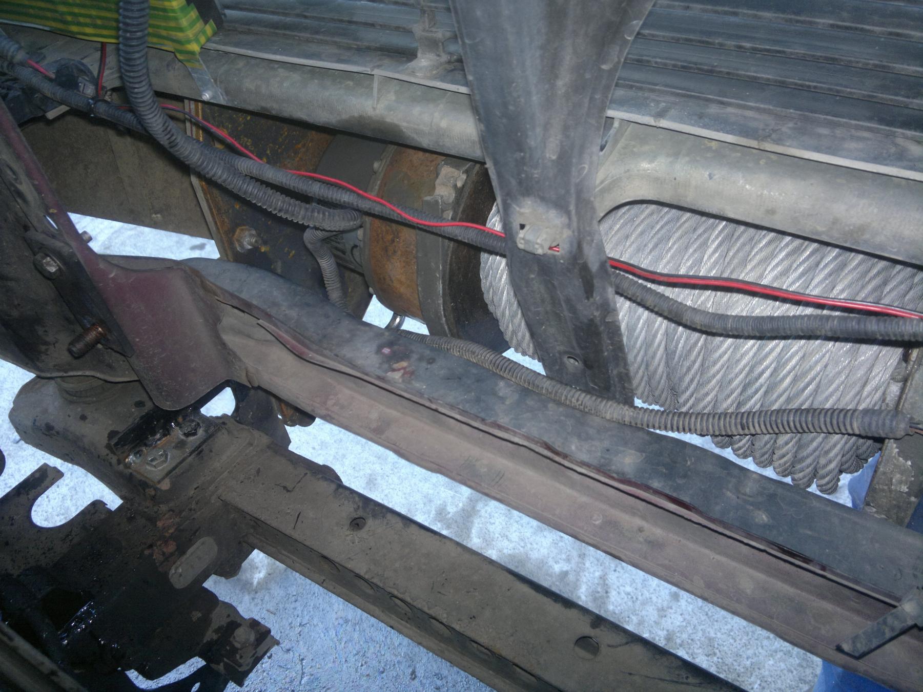

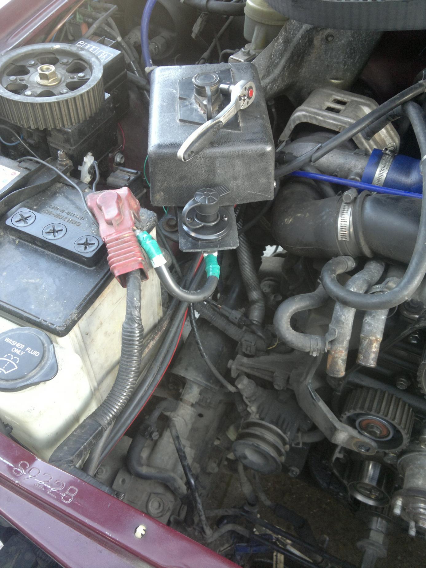

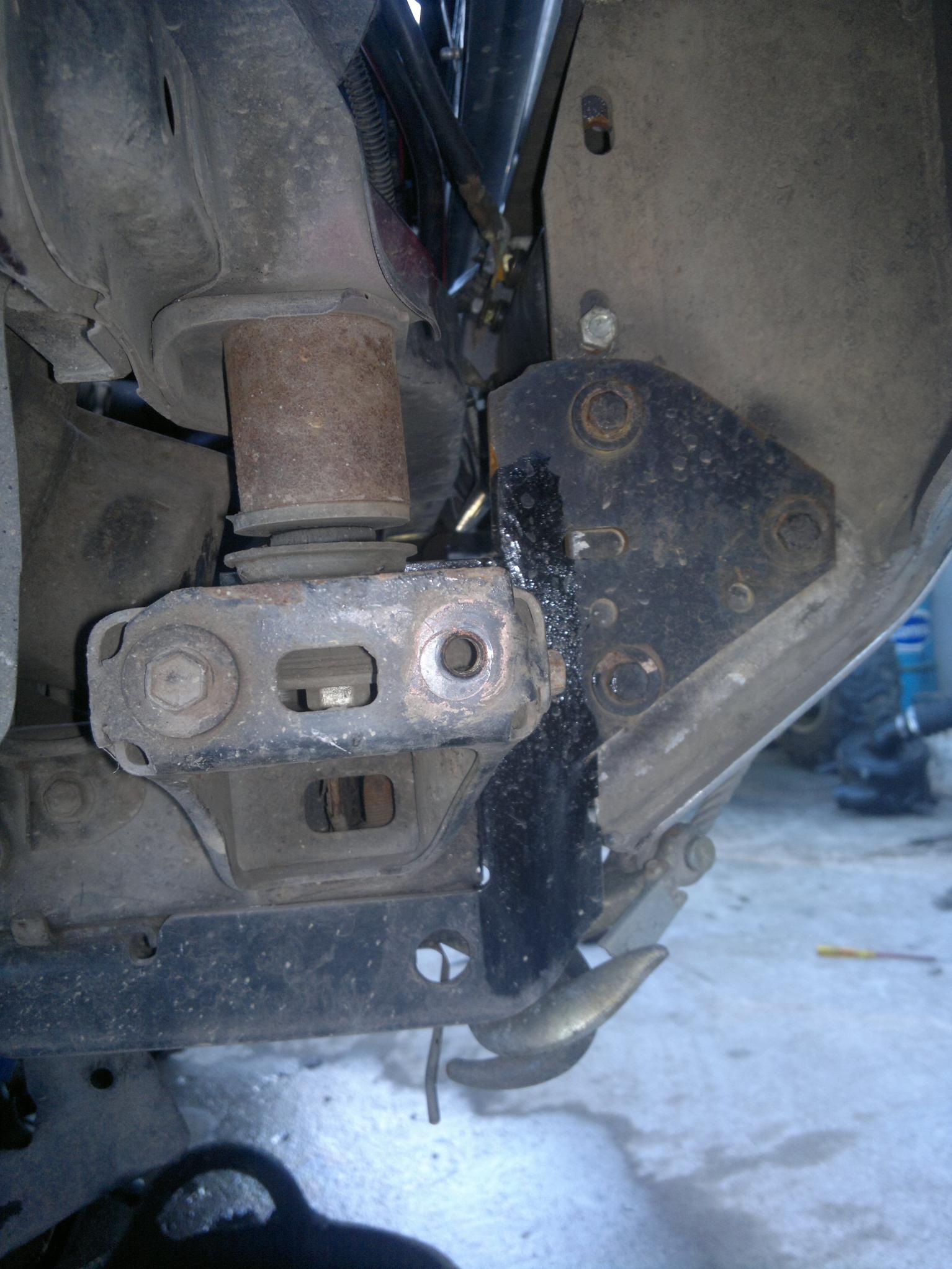

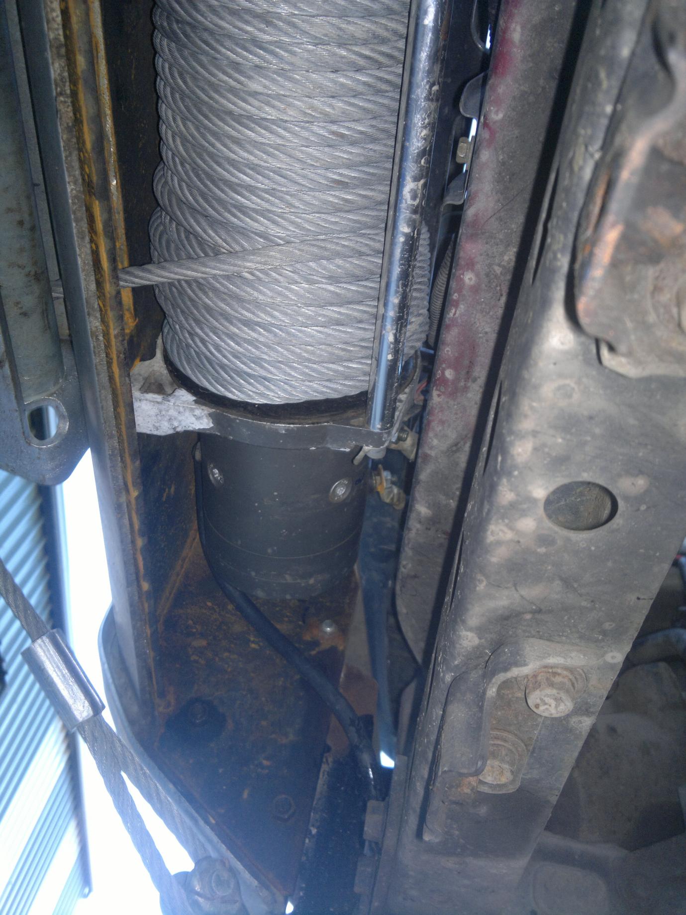

        whinch fitted upside down to avoid cut for the free Spul (not sure how to write that word, hope is right) made a plate same shape of the bumper on the inside and atached to the legs of the bumper (extended 2" for the lift) and attached to the chassis. didnt use yet for heavy stuff yet due im replacing the fuel pump.
        the cables inside, like this got less trouble with the solenoids (dry, less dirt, people, ...) hope that helps.
        i will accept same suggestions how i got it done, to improve it, due im not an mechanic, or got gold hands like bushwacker.
          nice one cheers for that,I have noticed a few little bits that differ from my bumper,but its close!,looks like im cracking the welder out then,or if its too cold someone is getting paid to do it!
