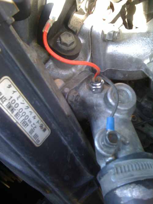

You can drill and tap the outlet pipe from the cylinder head as shown and fit the extra gauge(sender unit) while still keeping the original gauge and sender intact! You will be supprised just how inaccurate the Toyota gauge is when you compare the readings with the after market gauge!
