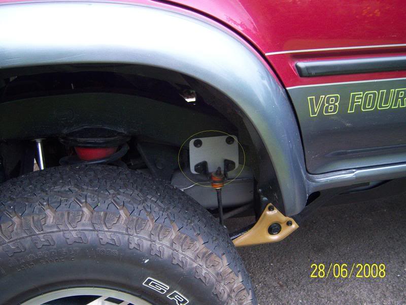

        Bushwacker, had the kit fitted today. The ARB rear links weren't long enough once the rear 2" longer shock's/springs were fitted - had to do a bit of chopping and welding to make them longer.
        I found another thread on here the other night where a plate had to be fabricated after lift to refit the original ARB links (thumbnail below). Why is it you think the originals should be long enough with the lift to fit back as is? Not doubting what you are saying, just that my mechanic couldn't get them to hook back up at standard length and looks like not only case.

            That I can't answer at the mo, but will find out. What I suppose I could do is jack it up, unbolt the links, let it down off the jack and see if they would then fit unbodged like you suggest.
