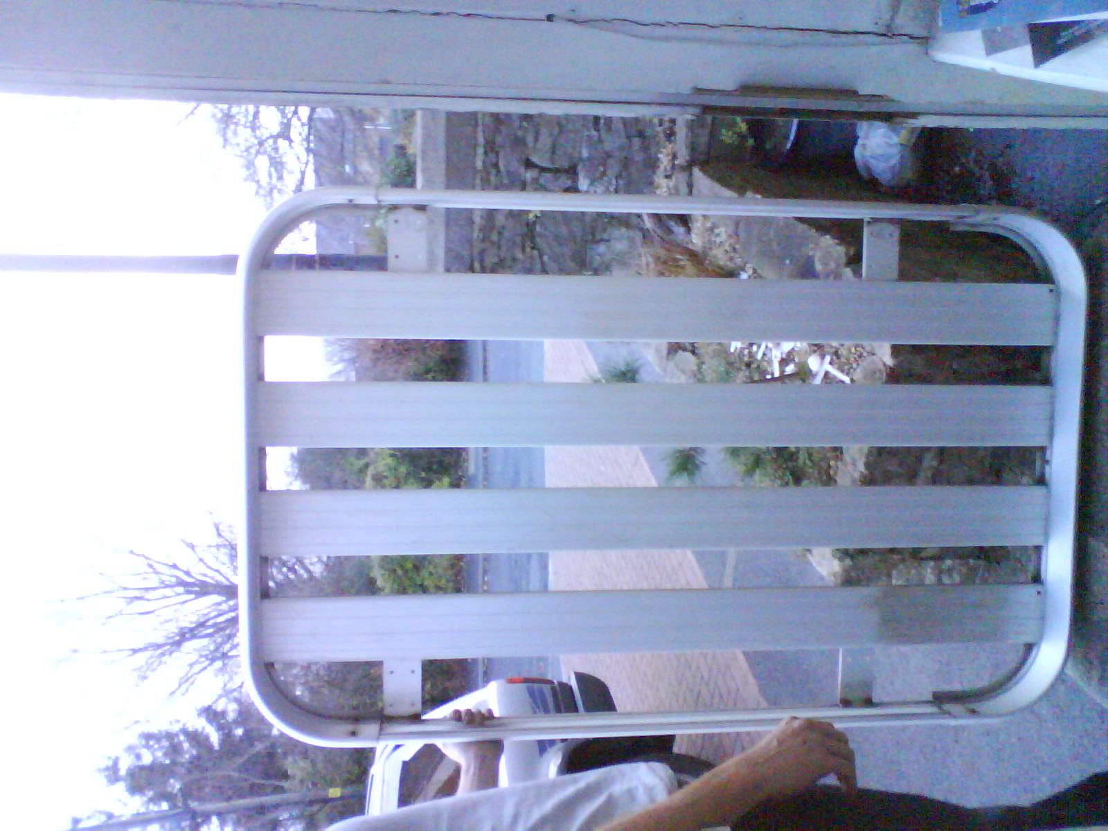

any ideas on how i could fit this,the front will fit to rooof bars,just behind the sunroof does anyone now a way of fiting it to the back,

 yeah its a thule lapland,a want it to sit behind sun roof so would only fit to roof bar on rear doors,seen what i want before wen a was out there the ones off a ford explorer,have to measure in see if they will fit,do you have a pic of yours fitted,thanks mines a 2nd genOriginally posted by Hawaii View Postthat look like a Thule Lappland roof crate - exactly the same one I've got fitted to mine.

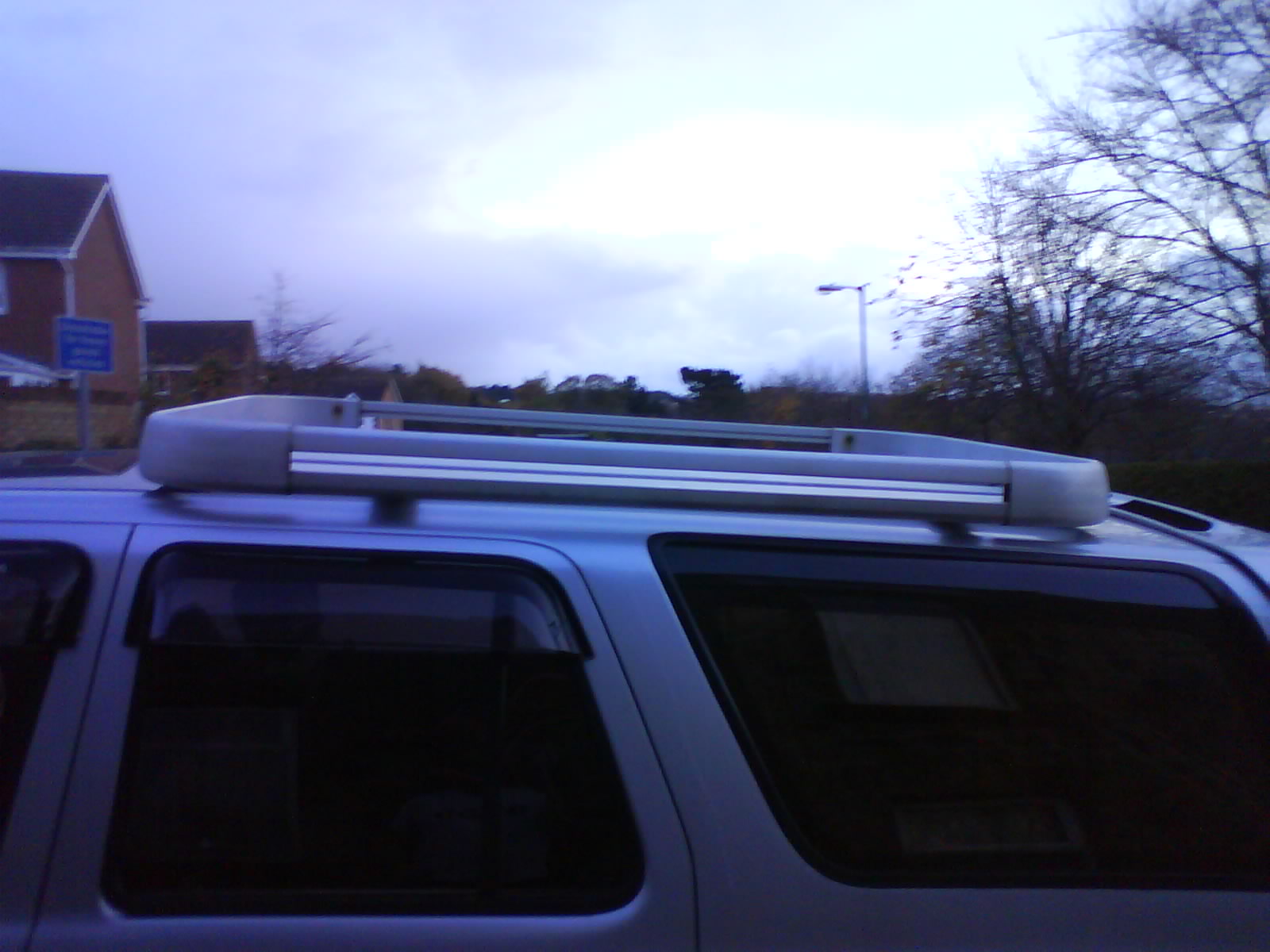

 These were off a swb model iirc. Need to drop roof lining, drill 8 big holes and I made up some 3mm steel plates to strengthen the insides (rather that use washers.) Fairly easy but making sure the positions are perfect is the challenge. I made a jig out of plywood so my drill holes were spot on.
 Rob.
