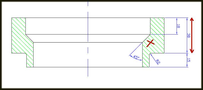

I remember when I made my spacers that for a small spacer (I wanted a 3/4" lift but went with 1 1/4 to keep some strength in them) theres not too much space available on the chassis side due to the locating 'bump'. Are LC coils a larger diameter than the surf ones ? This would mean I could probably make you up a pair from nylon. If they need to be alloy for strength reasons I can't help.
Rob.
I've attatched a drawing of a 'standard' 38mm spacer. If you made it 12mm it would lose all the meat in the area marked X. Easier to understand than the dribble above

A locator as built by 'stein is abour 1/4" thick, so after you pull off the original locator its about the same. A half inch thicker one on one side isn't going to affect the rear geometry excessively in the great scheme of things.Cutting steps in the roof of the world
