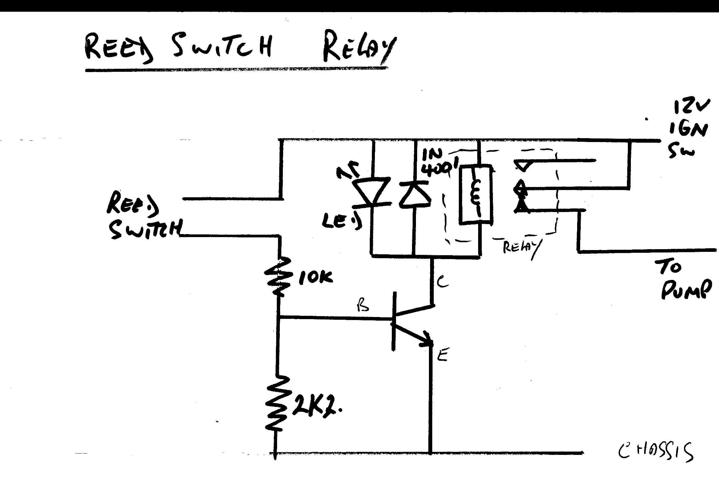

        If you need any small electronics done Popeye I will do it and post on to you just for the parts/postage cost. Small bits like relays are available from the scrapyard for virtually free and I have lots of electronic junk in the loft.
        My swirl tank cost about £3 in total.
        I have attached a wiring diagram for the reed/relay circuit.
