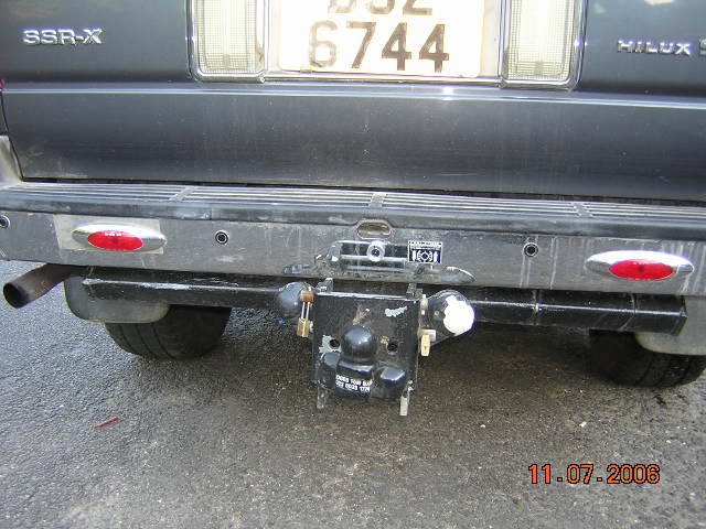

    Right on the first picture you can see the camera, nicely placed above the towbar (it is possible to just see the top of the ball on the monitor, so no more shouting at mother "which right" and getting the reply "well your almost there").

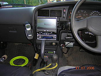

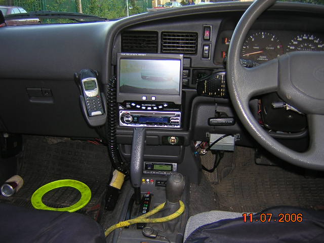

    Picture two, you have the monitor above the radio, I've used the CD changer input for the TV/audio inputs, and reconnected the RF Modulator for the changer which is in the boot. In front of the gear stick you can see the three inputs (visual, audio left, audio right), and just behind that is the RF Modulator controls (there is a remote somewhere).

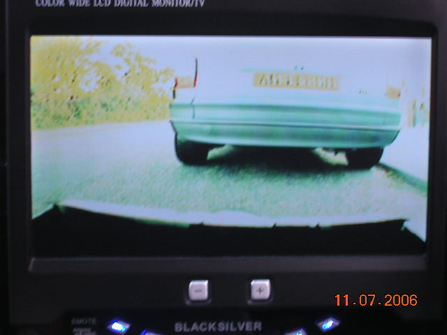

    Picture three shows the veiw you get, it is automatically reversed so it's the same as you get in the rear veiw mirror. The car you can see is actually 4 feet away, it is possible to back up until you are touching very acuratley. The picture is a bit over white because it was in direct sunlight, with a bit of shade and the picture is close to purfect.

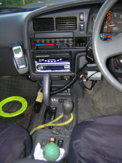

    The final picture is with the unit off, nice and neat eh?
