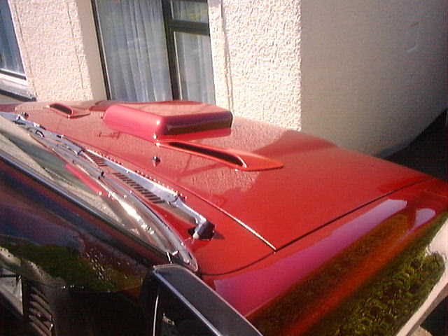

                Any update on the end verdict yet, Mike?

                  Originally posted by ian619
                  Nice job Mike, I'm in the middle of doing a similar thing only with two smaller vent's either side with two 12v pooter fans on each one, Yours should be more effective though, only useing these cos i did'nt have to buy em, Have you don the electric fan switch mod as well,
                  Hi - are you taking orders??
                  I'd like to add some cooling to my 2.4, Im looking into the feasibility of installing an intercooler from a Shogun, quite flat and small, as well as some vents with or without fans - and may look at putting something like this into the bonnet to create a kind of Ram-air system to force cool air into the air box......
                  • #24

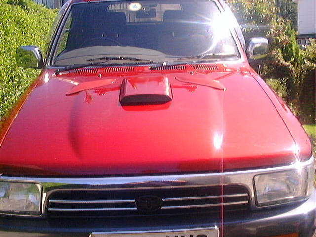

                    Like this?

                        Originally posted by Tallyman
                        Hi all,
                        No I haven't had a chance to test it out properly yet. That should happen on Saturday on the way to Truro (fingers crossed!!), although when coming back from filling the tank tonight the extra temp guage did seem to be showing a bit lower temp than usual, even without the fan running.
                        Yes, it does move a lot of air; just sticking it on when the car is stationary seems to create a gale out of the exit from the cowl. Should be even more when moving. The hole should also help to move air out anyway even without the fan on. We'll see if I've spent wisely this weekend.
                        No, I haven't done the electric fan switch mod. I presume you mean the one on the aircon rad, as that's the only original equipment radiator electric fan on mine. It's something I'm going to look at later.
                        I was thinking about pop riviting the cowl on, so that when I get round to respraying it with the correct colour it will look a little more like it's meant to be there. However, having thought about it, if the fan needs maintenance or repair it would be harder to remove the cowl if its riveted, although the black roofing sealant that I spread around the edge of the cowl will also tend to make it difficult to remove anyway.
                        Just a little thing that i found out when changing my rad to a four core rad. Where the rad meets the top scuttle plate (where the bonnet latch fits) make sure that the gap between is sealed with a piece of sponge. The reason for this is that the air will take the easy root and when this gap is present it dose make a difference. If you still have the original foam still in place forget what I have said.
                        If the hill you are refering to is the one on Bodmin Moor your are not alone. It started to cook my surf once.
                        All the best & safe journey.
                        Rubblebags.

                          Update
                          Hi All,
                          Back today from two really glorious weeks in Cornwall. Best holiday we've had in the UK for sunshine for years!
                          Journey back today was horrendous with queues on the A30 approaching the Truro junction (A390), the next junction north of that, massive tailback of about 4 miles of solid unmoving traffic approaching Indian Queens (should be good in late 2007 when the new dual carriageway is completed but complete nightmare today), another approaching the A391 junction for St Austell and again approaching the single carriageway bit towards Bodmin, then again about 3-4 miles of slow traffic approaching the M5 junction.
                          Through all that and both on the outward and homeward journeys the temp stayed either normal, lower than normal when cruising or only got up to about 98-100C when towing on the uphill bits and use of the fan brought that down or kept it under control. Most of the time running solo without the fan turned on the temp stayed either at or below normal, even when running around in +30C outside temperatures the first week there. Mind you I could only tell all this from the additional temp guage as the standard one didn't move at all off it's normal central position, whatever the other one showed.
                          Overall I'm pleased with the outcome and think it was money well spent.
                          Mike G
