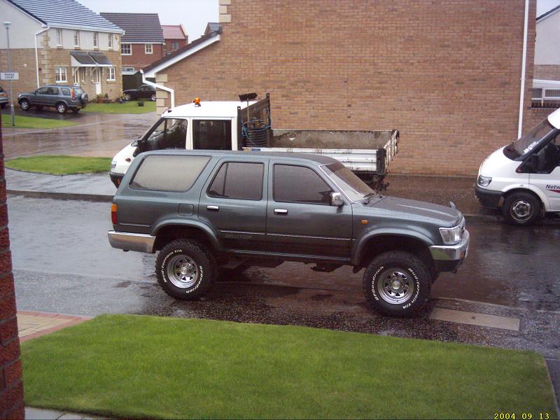

i bought the kit from supertrux. 4x pro comp es9000 shocks, 2x uprated torsion bars, +2" rear coil springs.
well worth doing as it makes a hell of a difference.
this is probably not the cheapest way, but like yourself i know naff all about this kind of thing, and i got someone to fit it for me.

What happend regarding the panhard rod bolt, did you manage to get it out?
Truck looks well 'ard!
nop, tryed everything to get it out. i can turn the bolt slightly, but it is as if the bolt is corroded onto the bush.
so panhard rod drop bracket is lying in the garage collecting dust.
i really need a bush so thet the bolt can be burned off, which will destroy the bush. you can buy the bush but you have to buy the panhard rod with it £120. dont think so.
so if anyone has one lying about please let me know and i will buy it off you.
