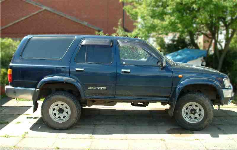

    .....no saggy arse now! I'm trialling some Roger Brown 2" coil spacers- not sure if I'm going to keep them on yet though.
    What do ya think?

    Looks good.
      Smart!
      Wher did you get them?
        What rear srpings do you have? Yours is higher at the back than mine and ive got procomp 2" lift springs, yours look the same higher still.......looks great
          If you don't keep em on I would be interested in buying them off you - my truck needs something done. Got a 2" lift kit 2nd hand but the springs are tired I think.
                I have Propcomp +2" rears (which I think have sagged after 2 years use). A 1" spring spacer might give a more 'level' appearance- but due to the design of the spacer (it has an inner and outer step) I think 2" is a minimum size.

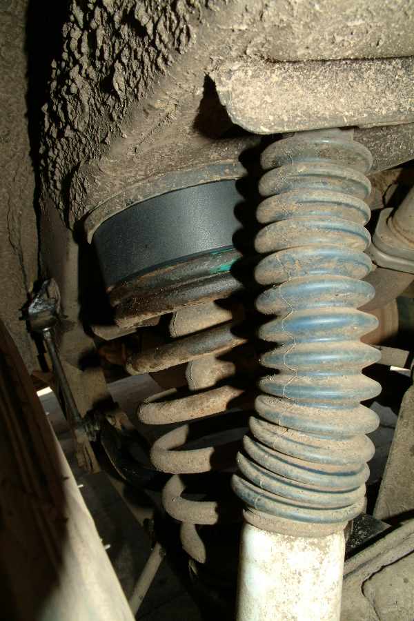

                    Very interesting. An photos of them fitted...? The actual spacers themselves rather than the result...?
                    AndyL
                      Yes, any chance of a photo of it fitted?

                          Toney is correct about the other mods that might be required. A longer, braided rear flexible brake is a useful addition anyway. The panhard rod dropdown bracket levels the panhard rod. Also worth considering would be longer shocks. I installed these 2" coil spacers on top of a 2" Pro Comp (bigger spring) suspension lift.
                          The photo shows the spacers installed.
