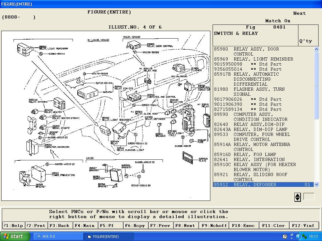

    does any 1 no were the relay 4 the rear defogger is? I hav checked the obviously places and checked the conections on the window and the switch in the car. Iam getting power 2 the switch and i hav checked the wires 4 continuity and iam getting it. can any1 shed any light.
    Suppose it depends on model youve got but on LN130 its on drivers side footwell RHS. Its one of a cluster of round relays. See attached
