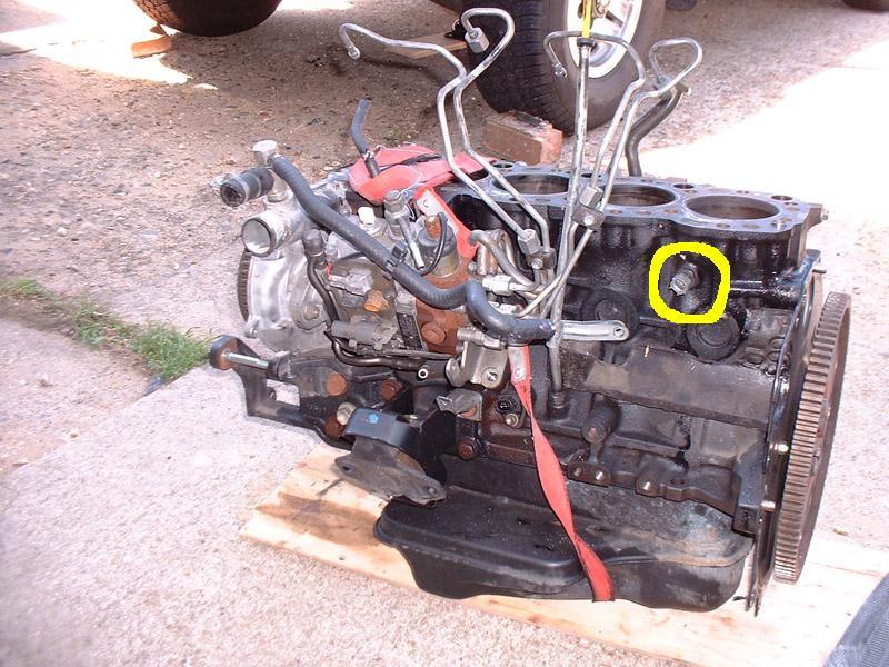

    Do you think it's a dodgy sensor or possibly a loose connection ?? I've seen a picture in a previous post that the sensor that triggers this fault code is actually near the block on the passenger's side. Is there a way of checking this sensor out without removing half the engine again ??

        The problem is, do I have to take most of the upper right hand side of the engine off to get at the sensor or is there an easier way of going about it ??
        I can see the wire going to the sensor and can just about wiggle it about but can't actually get to the sensor. Looks like alot of effort (again) just for a loose or dirty connection !!
        See attached photo from another post about the sensor
