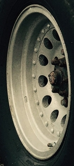

    My 'lux runs these gorgeous 15" rims. Any idea if they're 7" or 8" (or something else!) in width? Can't seem to find a definitive answer online.

    What's the tyre size? That may narrow it down. If you can also get a measurement inside the rim where the tyre beads seat that will get you close enough to determine width.
    Nev.
      Remove wheel. Lay on flat surface. Place a straight edge on top of tyre. measure from flat surface to underside of straight edge. Measure from underside of straight edge to where you think tyre bead sits inside the rim. Deduct twice this measurement from your first and that should give you a good indication of rim width.
