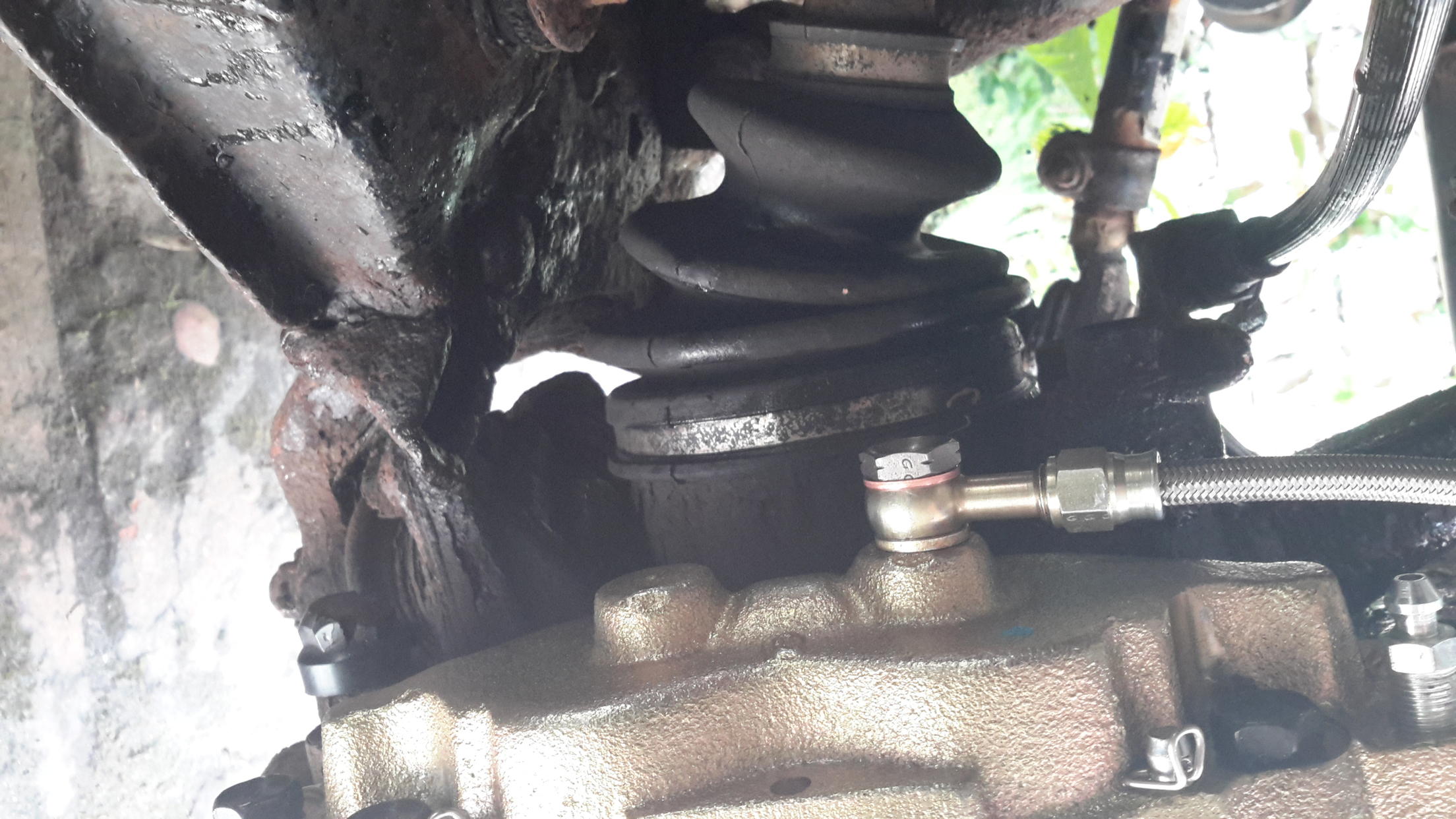

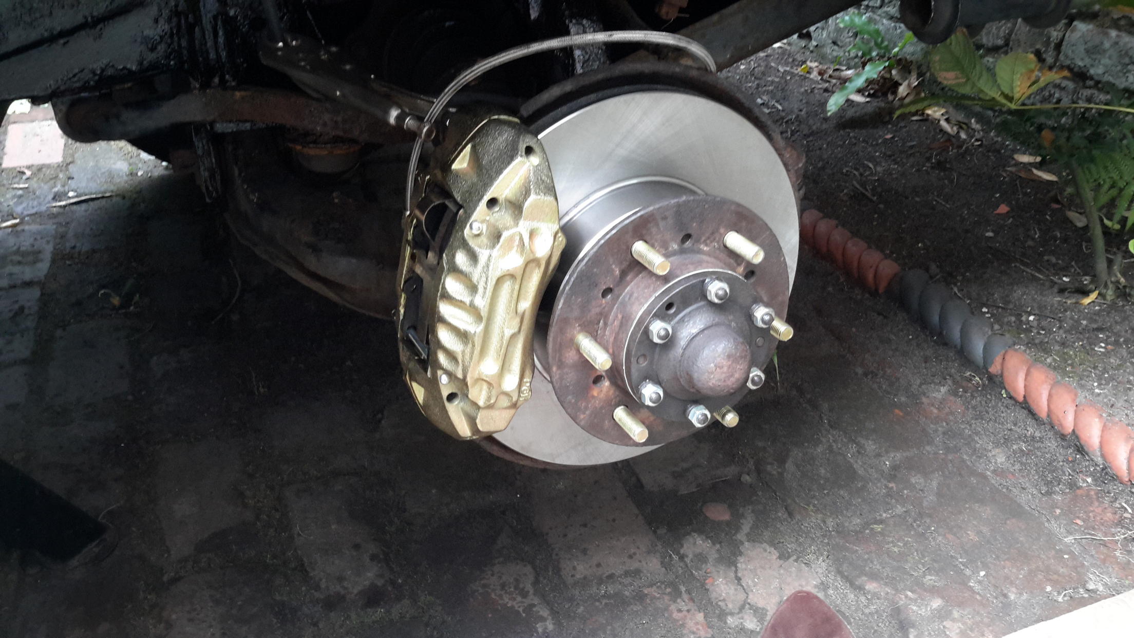

just to say had a good weekend replacing my front disc and calipers. (thanks to all the info on the forum)Also renewed my wheel bolts and nuts. A tip for anyone. I put my bolts in the freezer overnight which helped to feel that the grooves are aligned then push them home with my  press. Put on goodridge hose to replace the broken pipe, you will notice the washers are different thickness. I had to build up as the bolt was seating fully home in the caliper but there was still a gap which made them leak. question? how does anyone cut their goodridge hoses at home and still get a clean cut. my next job will be to replace worn suspension with a 2 inch lift.
new brakes and disc
