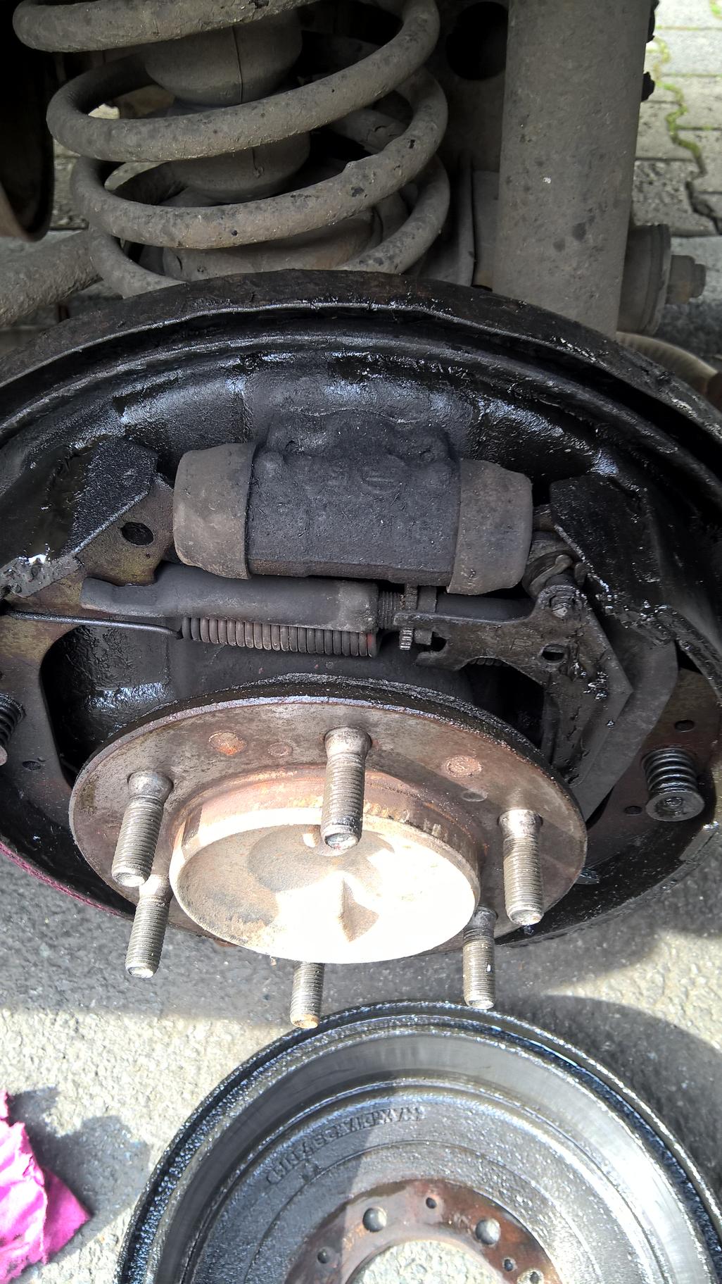

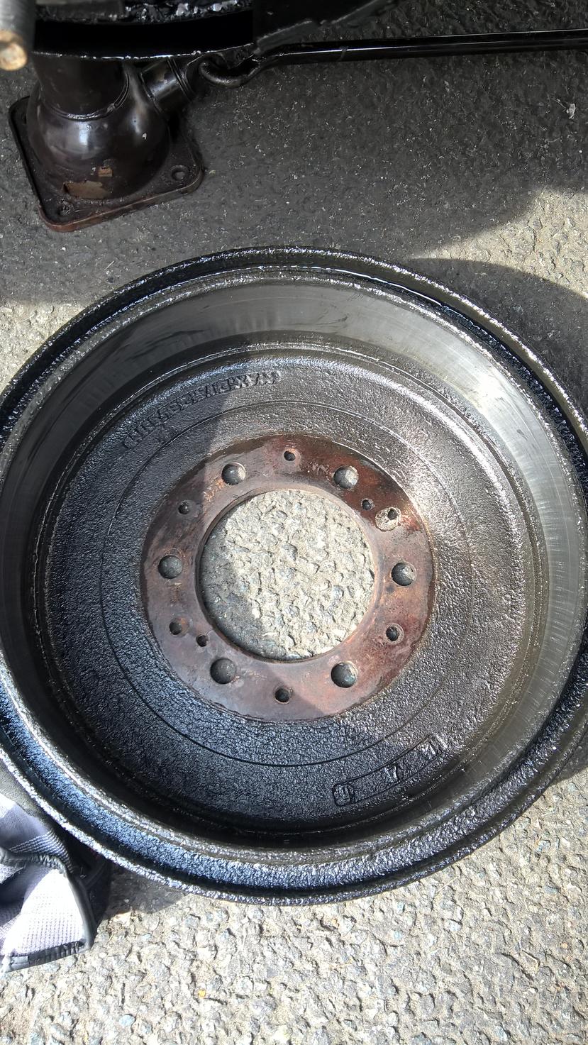

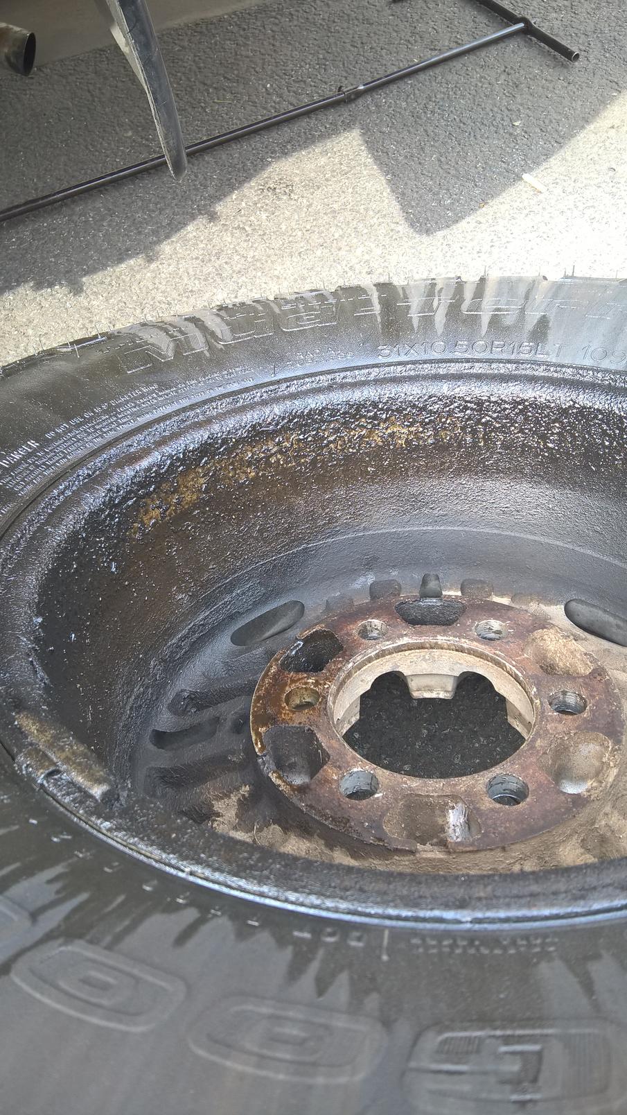

    Hello,
    I have again a problem with my Red Monster.
    Today I located under the Toyota to see if everything is OK, and realized the rear left at the brake drum and the tire a little oil.
    What is there again broken
    Thanks for your help
    greeting
    Martin
    Red Monster, KZN130 3,0 Litre Diesel
    it looks like you need axle seals, check the axle breather if its blocked, that might be the cause of the leak, (pressure buildup, and oil goes true the axle seals)
      Thanks for the answer, you have an accurate description for me, as I get the seal.
        your welcome, any help!
          Best to replace bearings and seals each side, when this happens.
          Nev.
