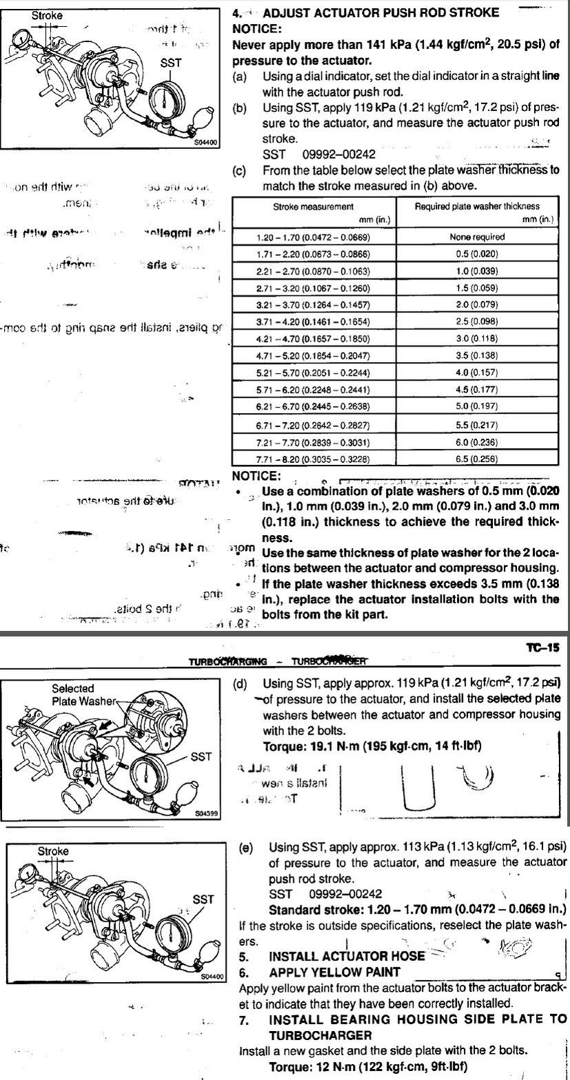

Now reading around the various forums I understand the 1kzte ECU doesn't like this high pressure, so at around 13-14 psi cuts the fuel - hence the surging and power loss I'm getting. My question is - How do I reduce the psi my new turbo is producing?
It seems to me that other than change the turbo [over my dead body], I could swop the waste gate actuator for an after market one [Mamba] and change the spring to open the waste gate earlier.
Is there another way, or am I over looking something. Thoughts very welcome.
