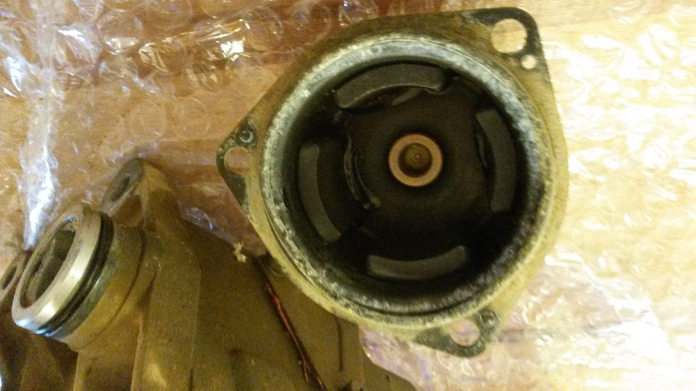

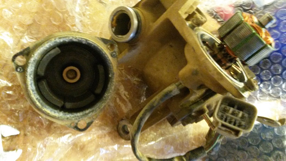

After a few months of trying I got my 3rd gen 2/4wd working again, and thought it might help others to know the story. The transfer box motor would work ok when not fitted on the transfer box, but not when reassembled. I found the factory service manuals 80Mb and spent several days of checking vac pipes sensors and ECU's etc.
I bought a 'nearly new' motor/solenoid assembly and fitted it ok, so my car is good for 2/4WD. I have a RZN185, although this is clearly a common part. This gave me another opportunity to look at the old one. The motor magnets had slipped around in the housing, (see pics: motor housing; magnets before; and after). If I had superglued them back in place, I wouldn't have needed the replacement.
