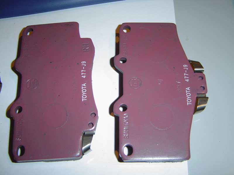

              The brake ware tab is a flat thin bit of metal, approx 5mm wide, attached to the front brake pads. usually you have about 2-3mm left on the pads when you get the noise. Not all pads have them fitted and sometimes people cut them off.
              Good luck with your noise hunt. Let me know how you get on.
              BEWARE OF THE REAPER
                Here's a pic I had handy. It's of the back of a set of pads from one side of my surf. 1 pad has 2 tabs and the other has 1. They basically rub on the disc when the pad is nearly worn out to tell you they need changing. Not the nicest of noises!

                    Had a look at the pads and they are low but not quite low enough to be making the noise.

                        i've endured weeks of embarassing squeaking from the underside - turned out to be the brake pads which i've now had changed, cost £20 for new pads & £20 for the fit - sorted......got mine from the local motor factors store who can supply most servicable bits for the surf.

                            Got someone else to check out the front of the surf, and it does look to be the brakes.
                            Going to replace them this weekend so will let you know if the noise has gone.
