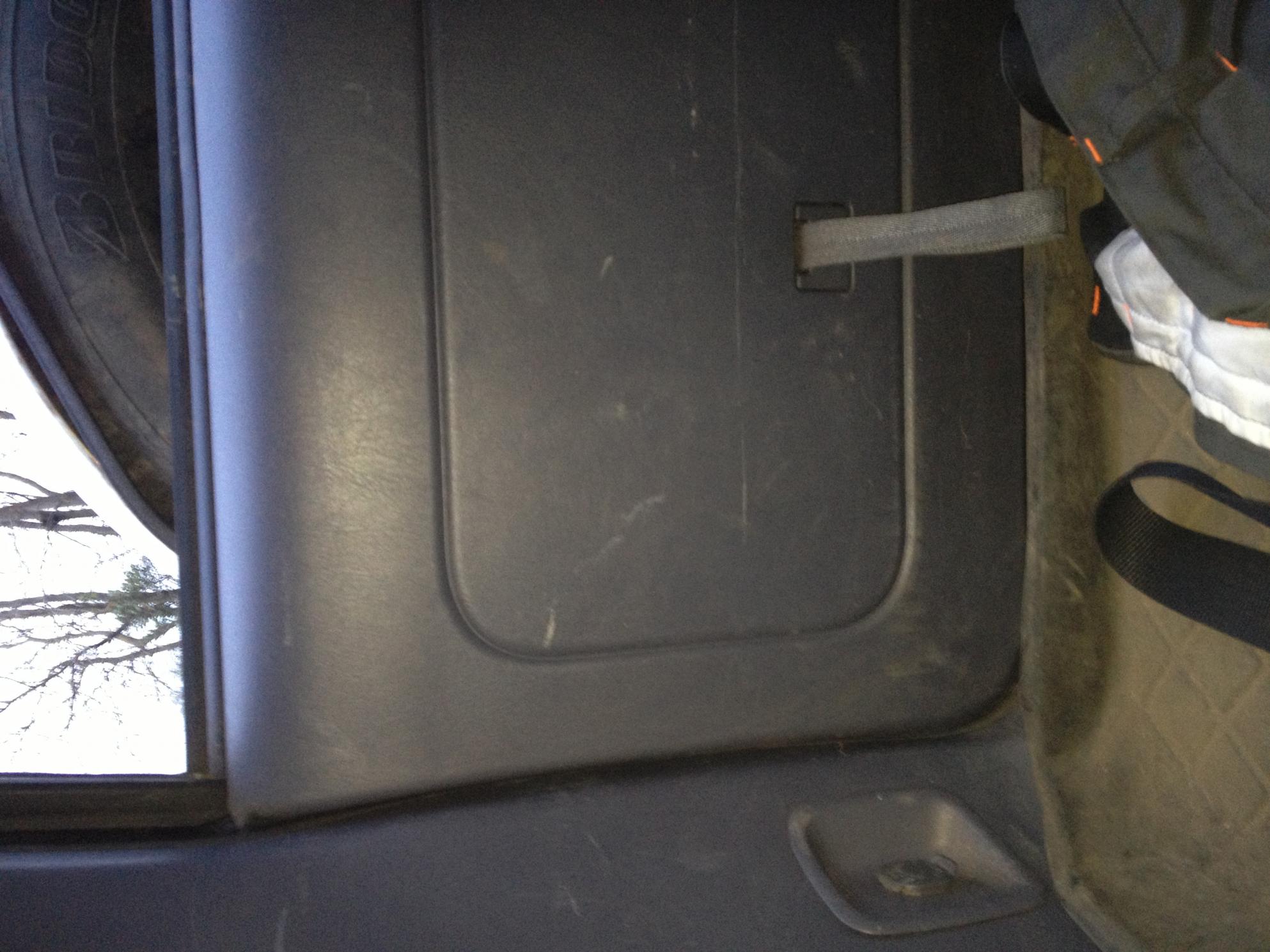

    Access to the workings is through the removable panel on the inside I believe
      It's a Gen3. Will post some pics later

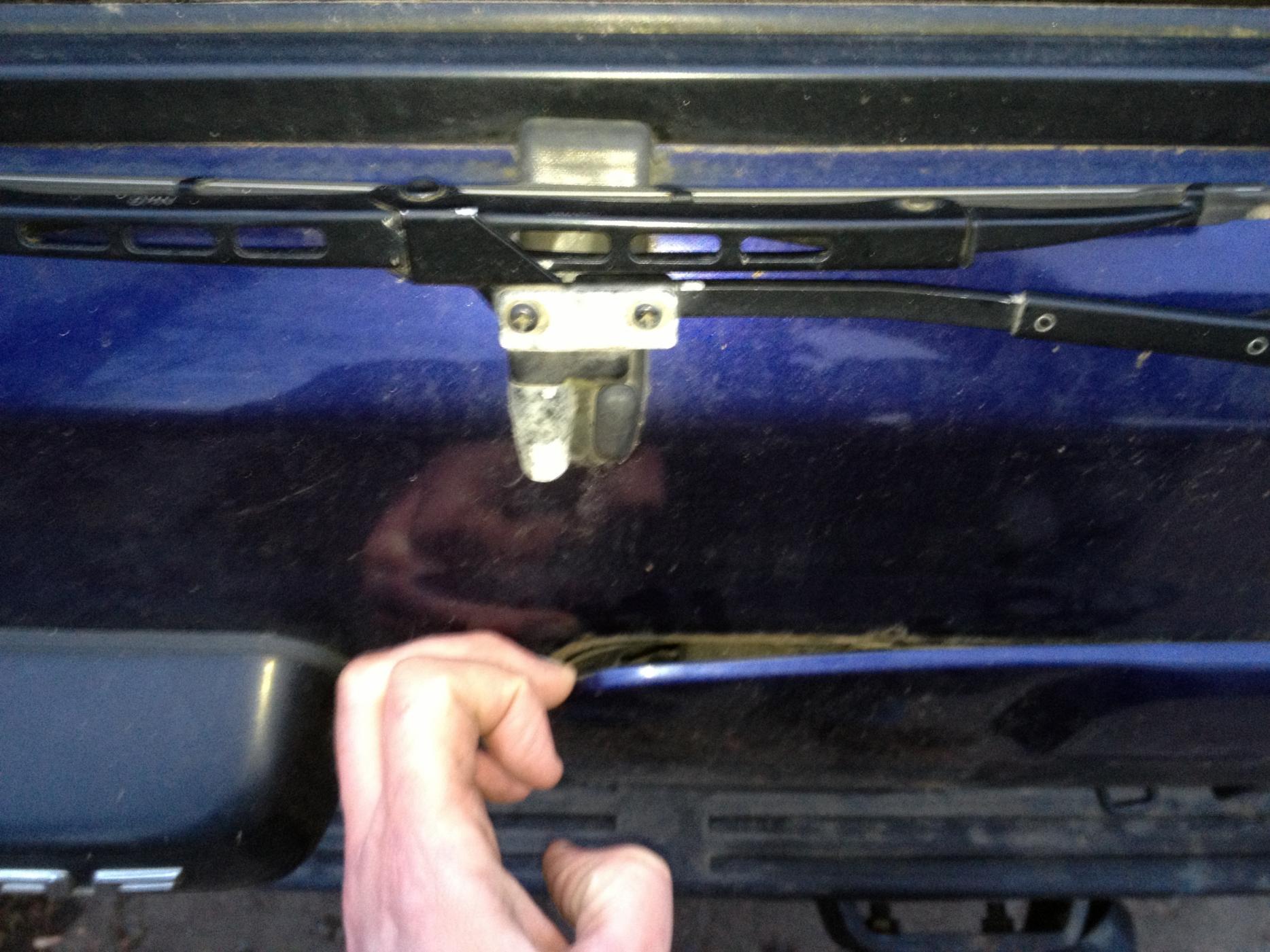

      As the back door won't open I can't see anywhere I can release the panel from.
      Any ideas?
      There is definitely a panel on the outside which I can pull open a little at the top left corner. Does this just pull off from the outside ? Or is it only possible to release that from the inside?

        A bit more info to see if these helps anyone give me some pointers.
        With the central locking locked with the remote, the door handle moves freely back and forward. No resistance.
        With the doors unlocked, there is resistance and you can hear/feel the handle moving the mechanism. It just won't release the catch.
