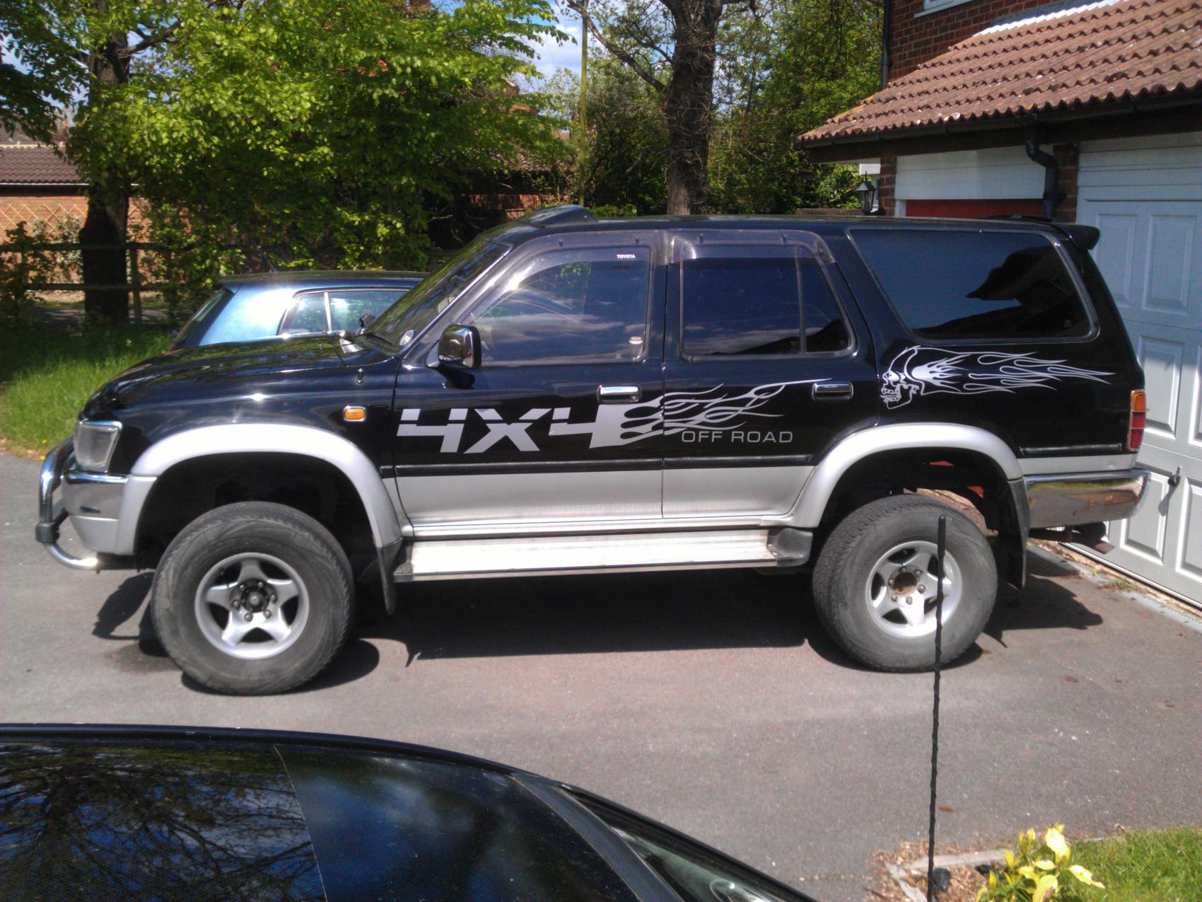

      All done!
      Before...
      and after...
      "2 higher. very happy.
      If I like it, Bushwhacker doesn't. :-)
      • #18
        Cool, definitely better looking. Should have taken the pic from the other side, I can't see my mirror from here
        Going to wind the front to match?

            I mean as in tweak the torsion bars to get the same ride height all round....though I know what you mean re the higher rear...
            They look so much better than standard lifted...though mine was only body lift not suspension as far as I know.

                Sorry to digress, but is that a vauxhall, possibly Vectra, roof aerial in your picture?
                • #23
                  It's his sunroof visor
                  • #24
                    guess again....think smaller...
                    • #25
                      Ah, so it wasn't a car ariel at all then!
                      Does that fit in the back of a surf?!
