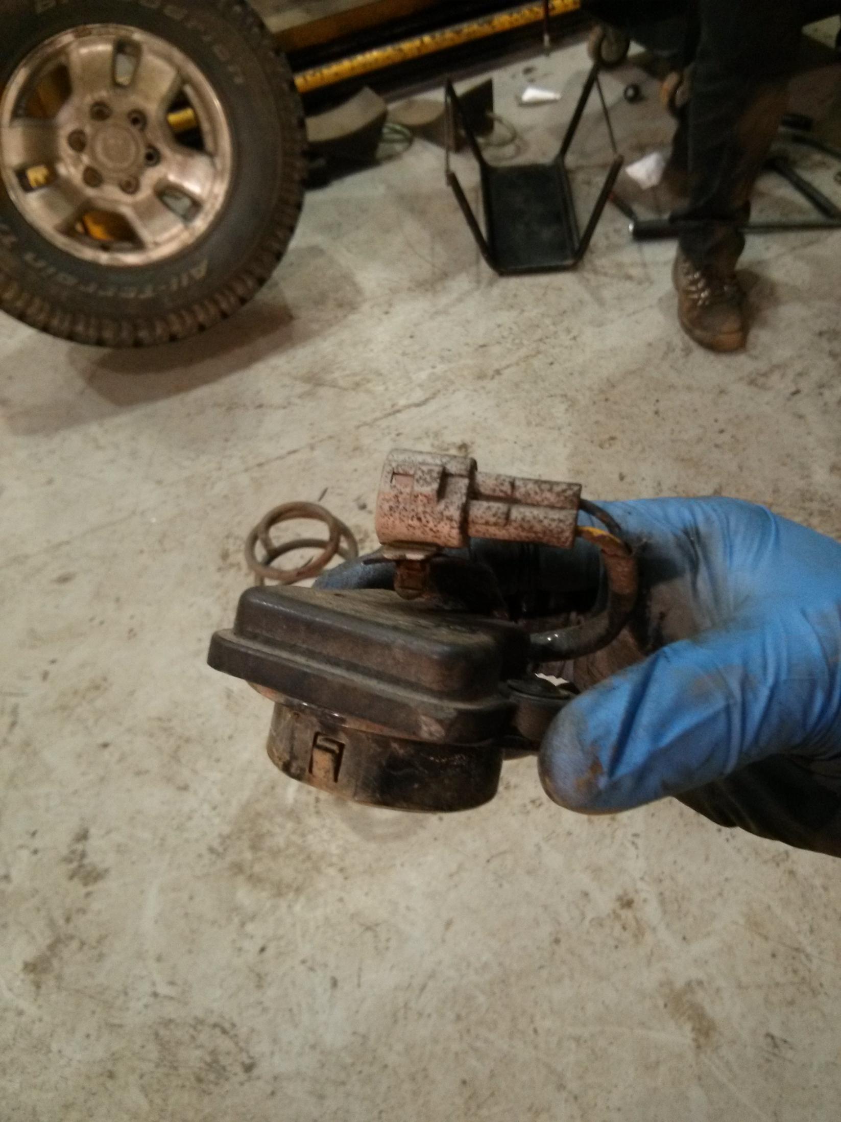

      shock absorber actuator mounts
      I've recently been through the same -- there's some chat on here about two bolts, but mine seem to have a pair of spring tabs either side you have to push in to remove the cap with the actuator, before you can get to the shock bolt.
      I took a pic of the ###### thing when I finally got it off, thought I'd share it in case it helps anyone else! front and rear are the same design.
