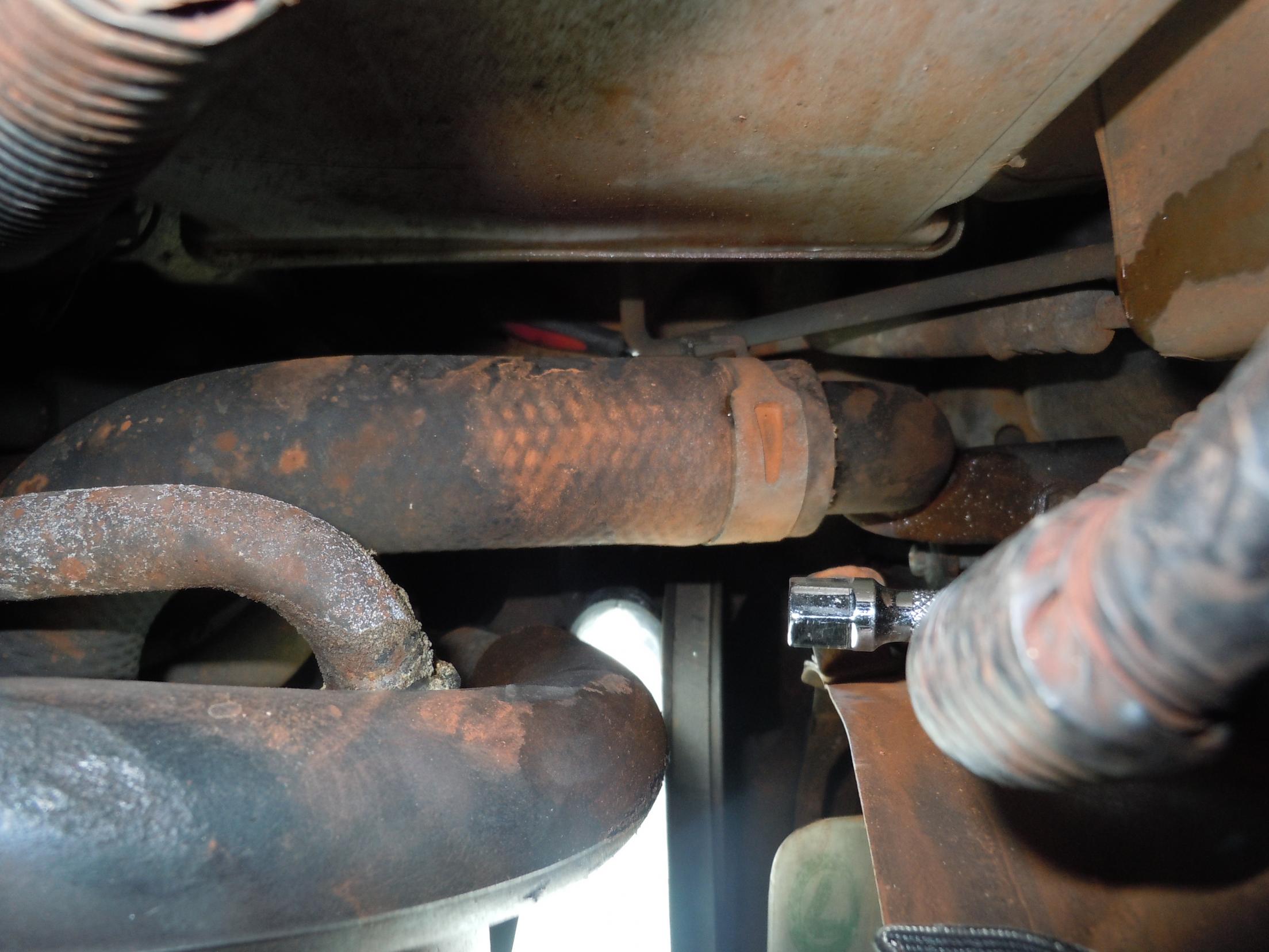

    Day 1

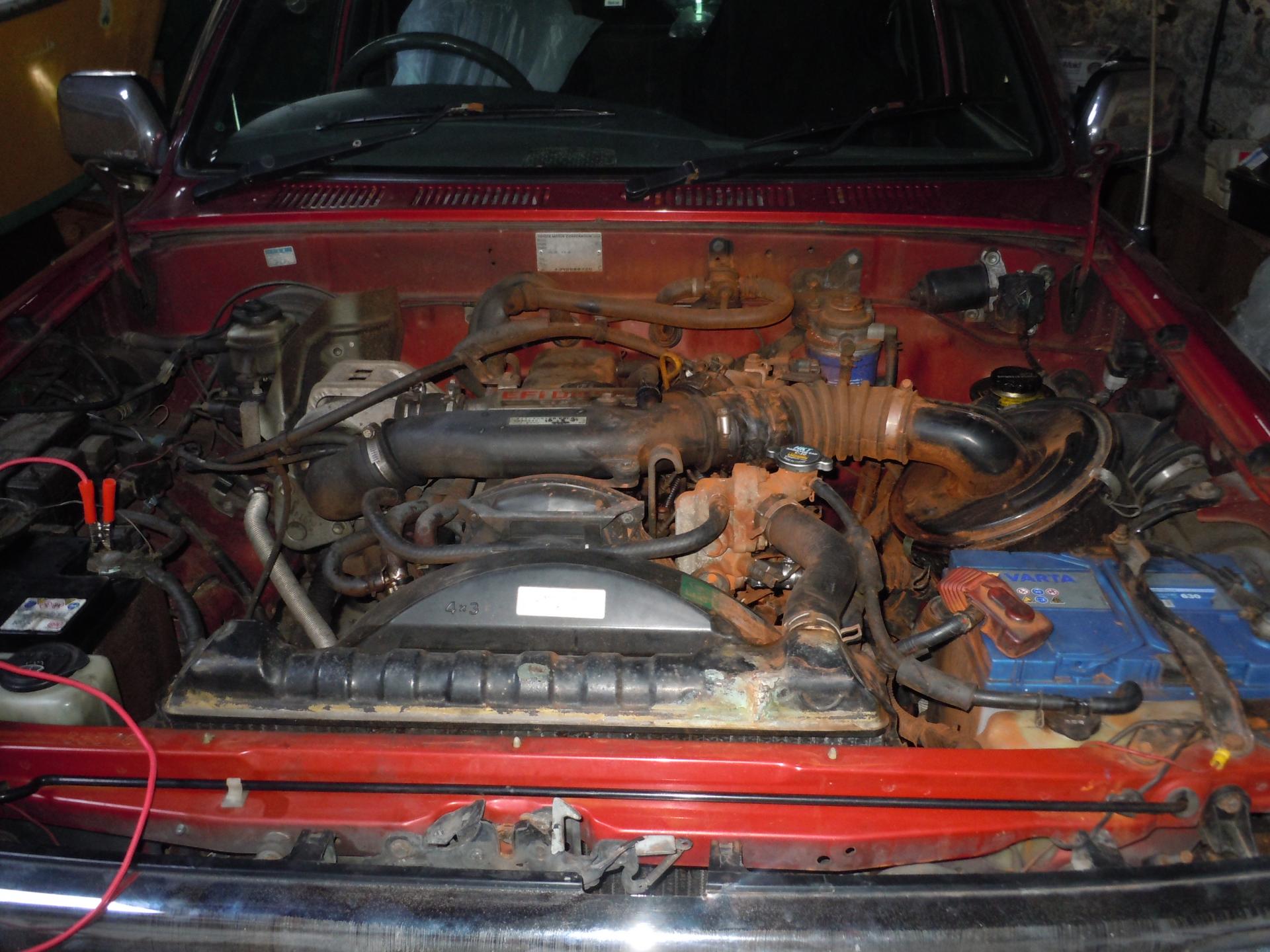

    I FINALLY MANAGED TO GET A START ON THE COOLANT SYSTEM
    HERES SOME PHOTOS

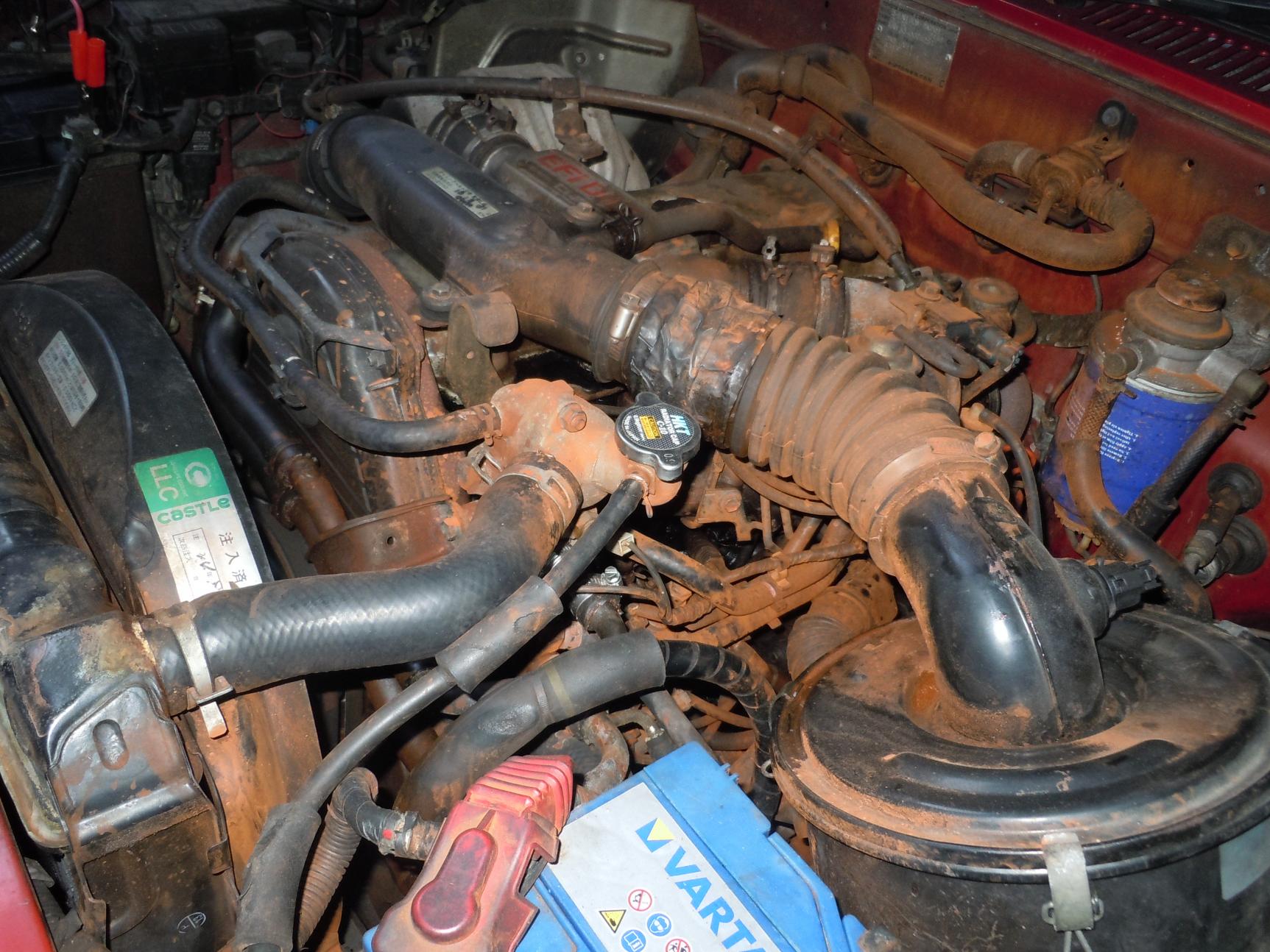

    WELL THIS IS WHAT I STARTED WITH ALREADY TOOK THE BONNET OFF WHAT A MESS

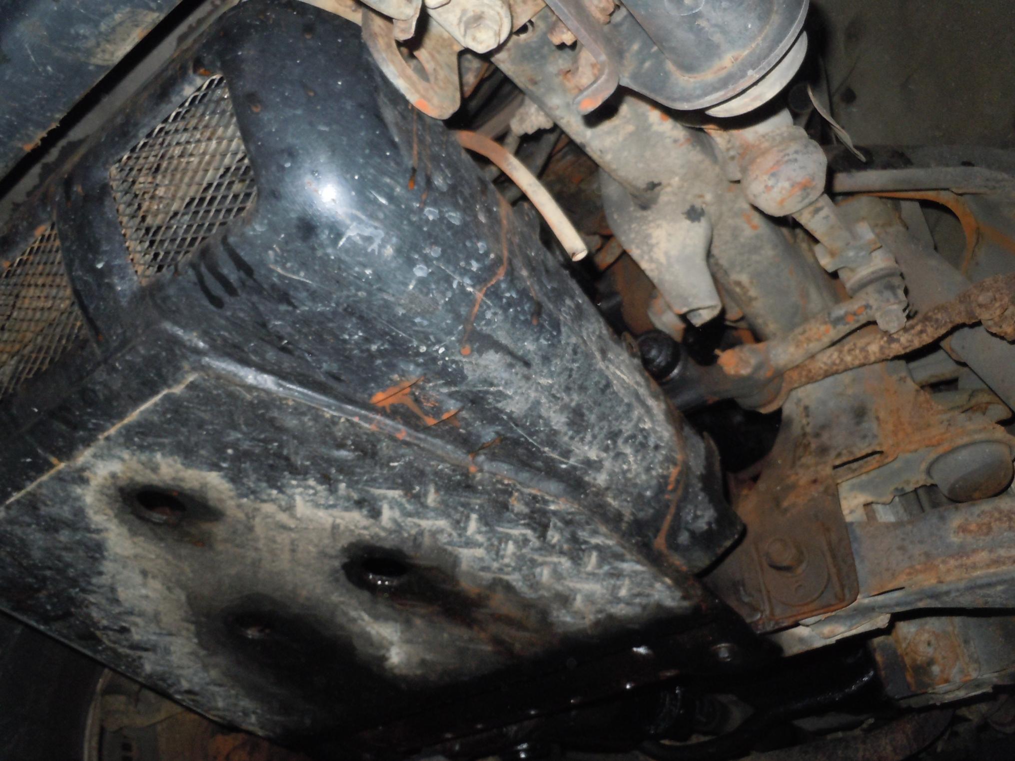

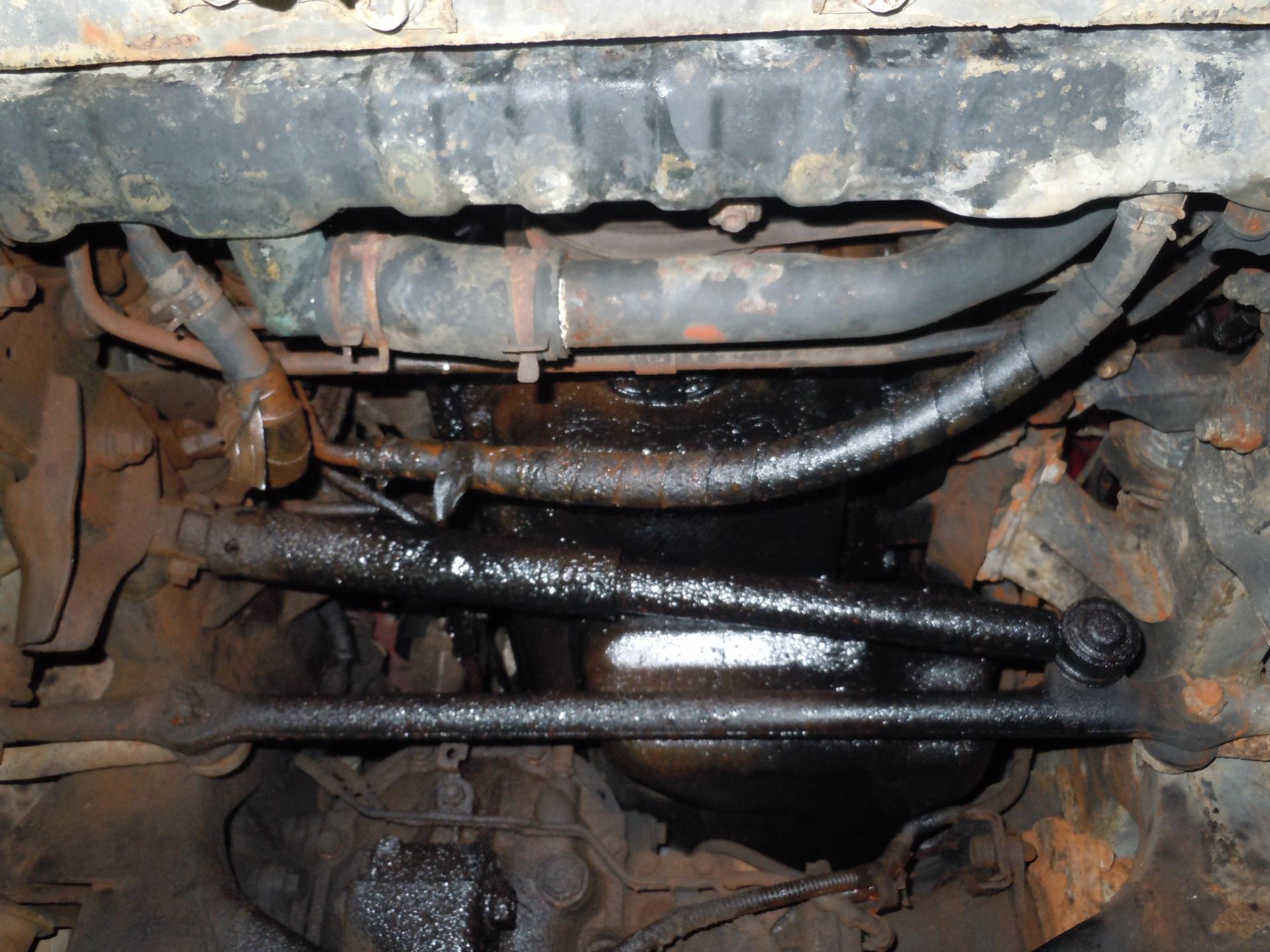

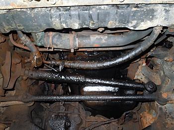

    STARTED BY TAKING OF THE ROCK SLIDE WONDER WHAT SUPRISES WE HAVE INSTALL

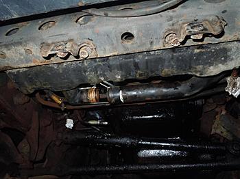

    LOVELY ON THOSE BARS WE HAD ABOUT 4-5MM OF DIRT AND OIL ON IT

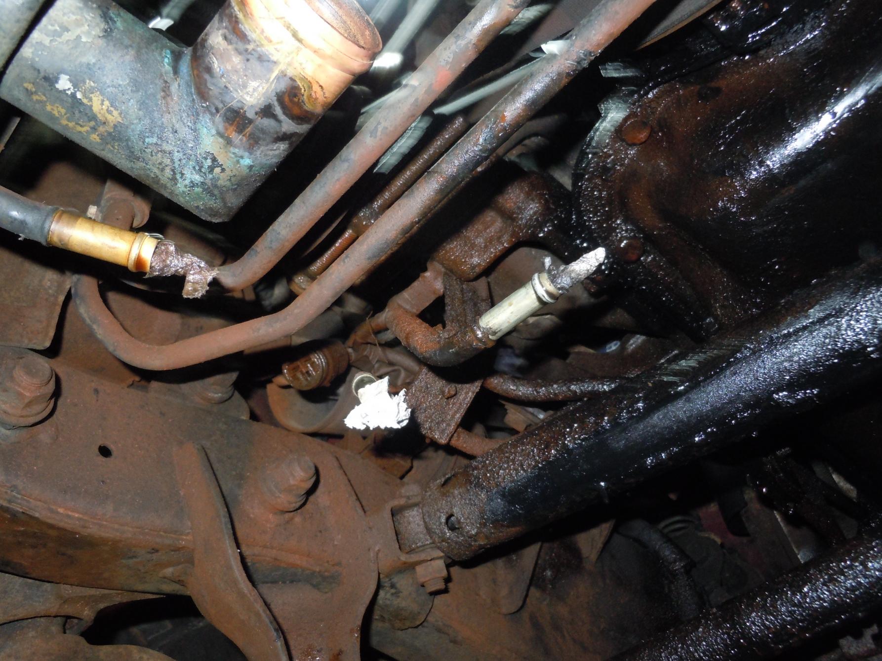

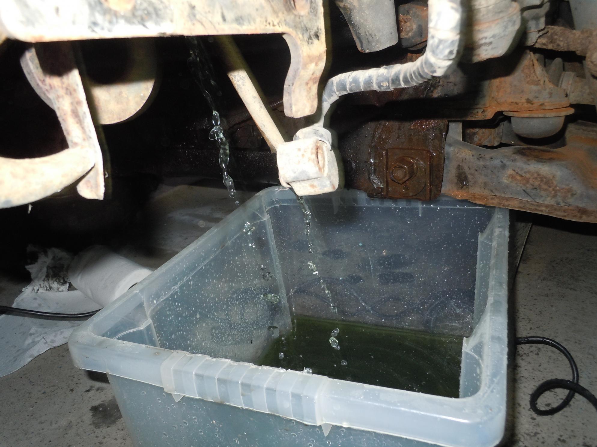

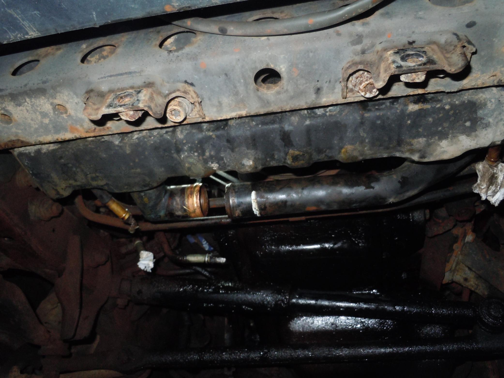

    TOOK THE PLUG OUT AND GUESS WHAT IT WENT EVERYWHERE AHH WHAT A MESS

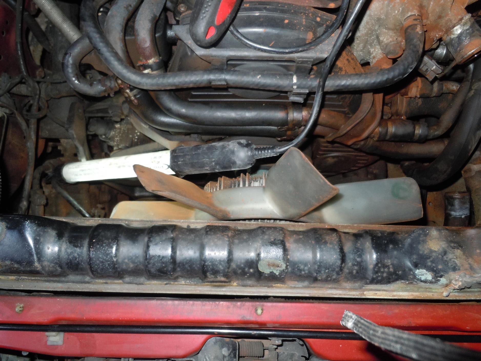

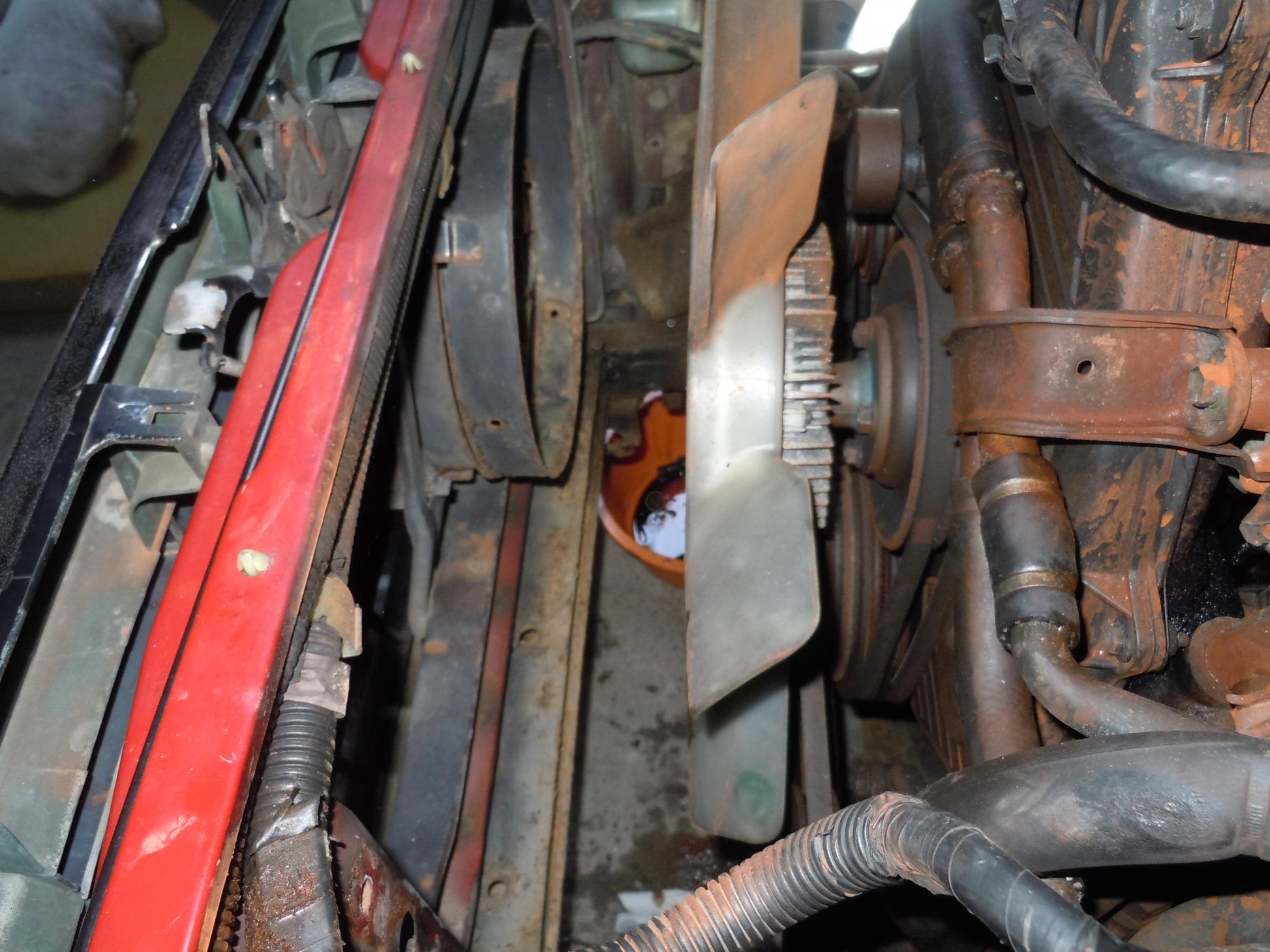

    WHILST TAKING THE VISCOUS FAN SHROUD OFF I DROPPED MY RATCHET SEE IF YOU CAN SPOT THE BLACK AND RED HANDLE

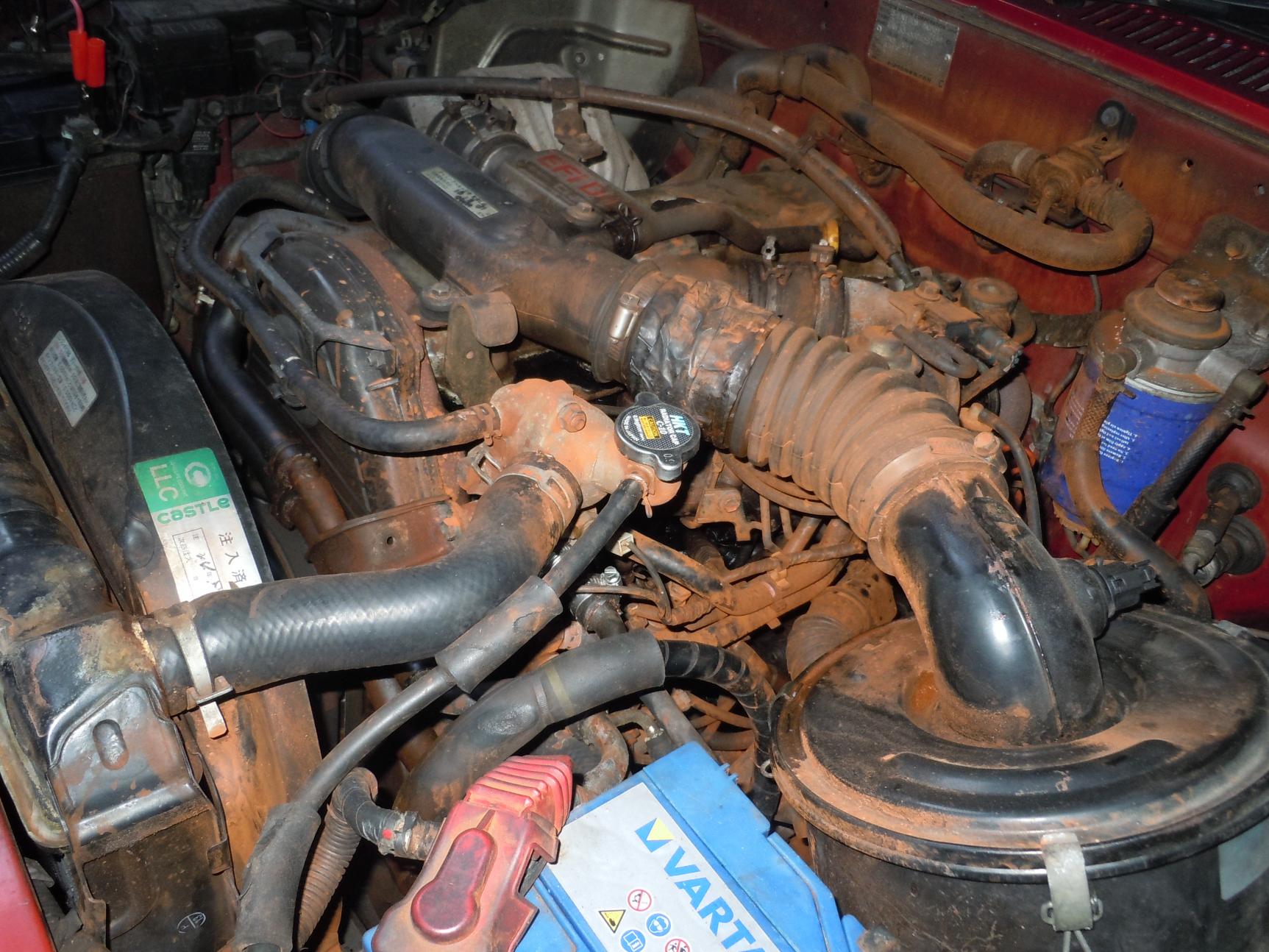

    I TOOK THE AIR FILTER AND BATTERYOUT MADE IT ALOT EASIER TO GET SOME PIPES OFF
    COOLER PIPES WHAT MORE CAN I SAY

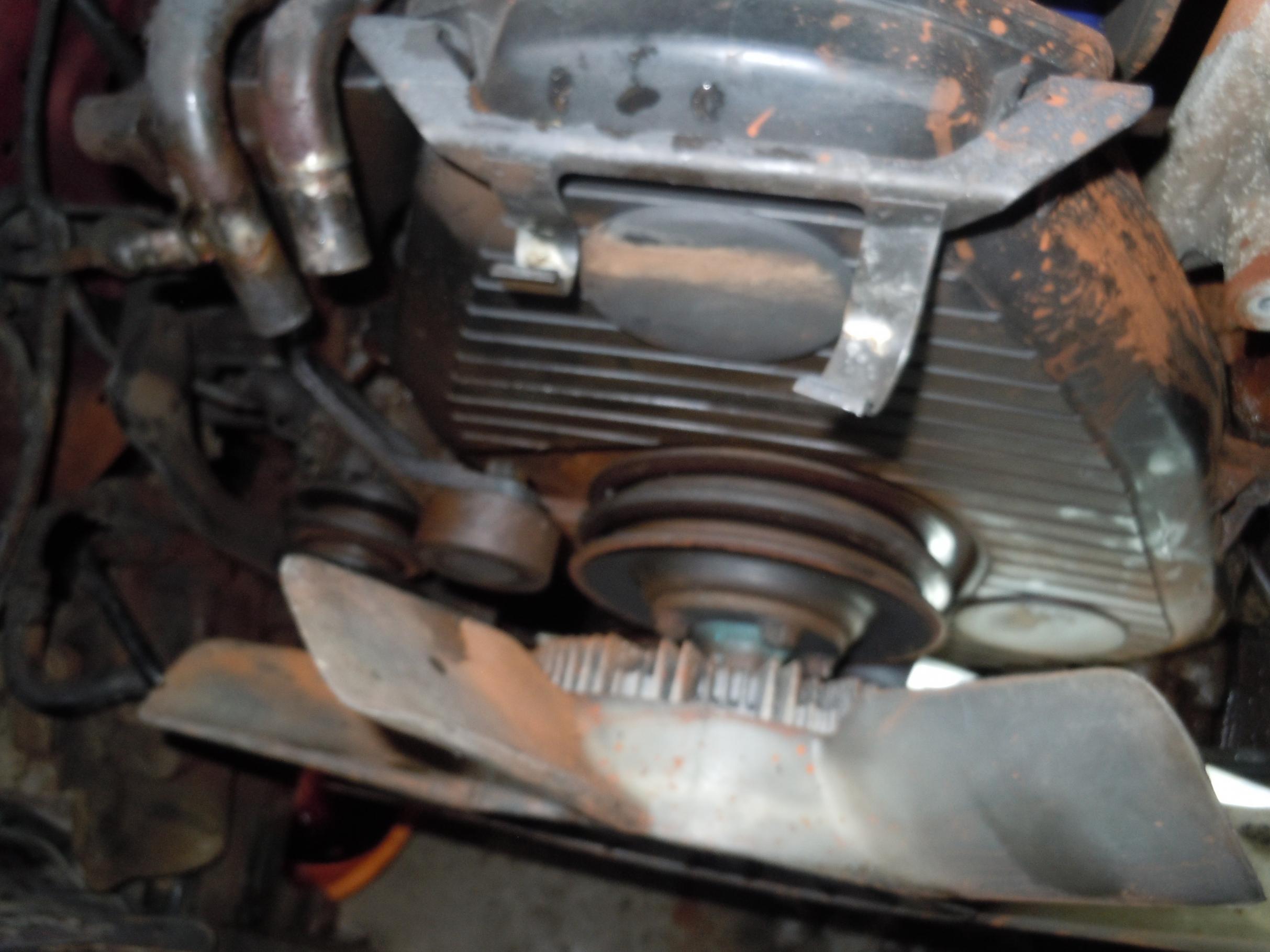

    GOT THE VISCOUS FAN SHROUD OF VIA 6 BOLTS

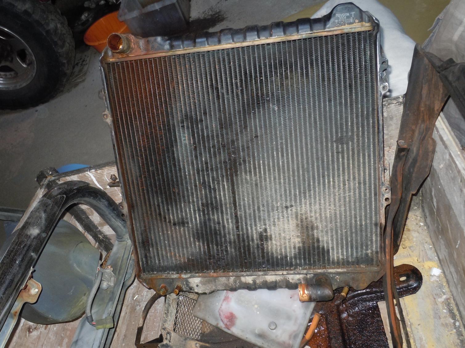

    THEN THE RADIATOR YAY

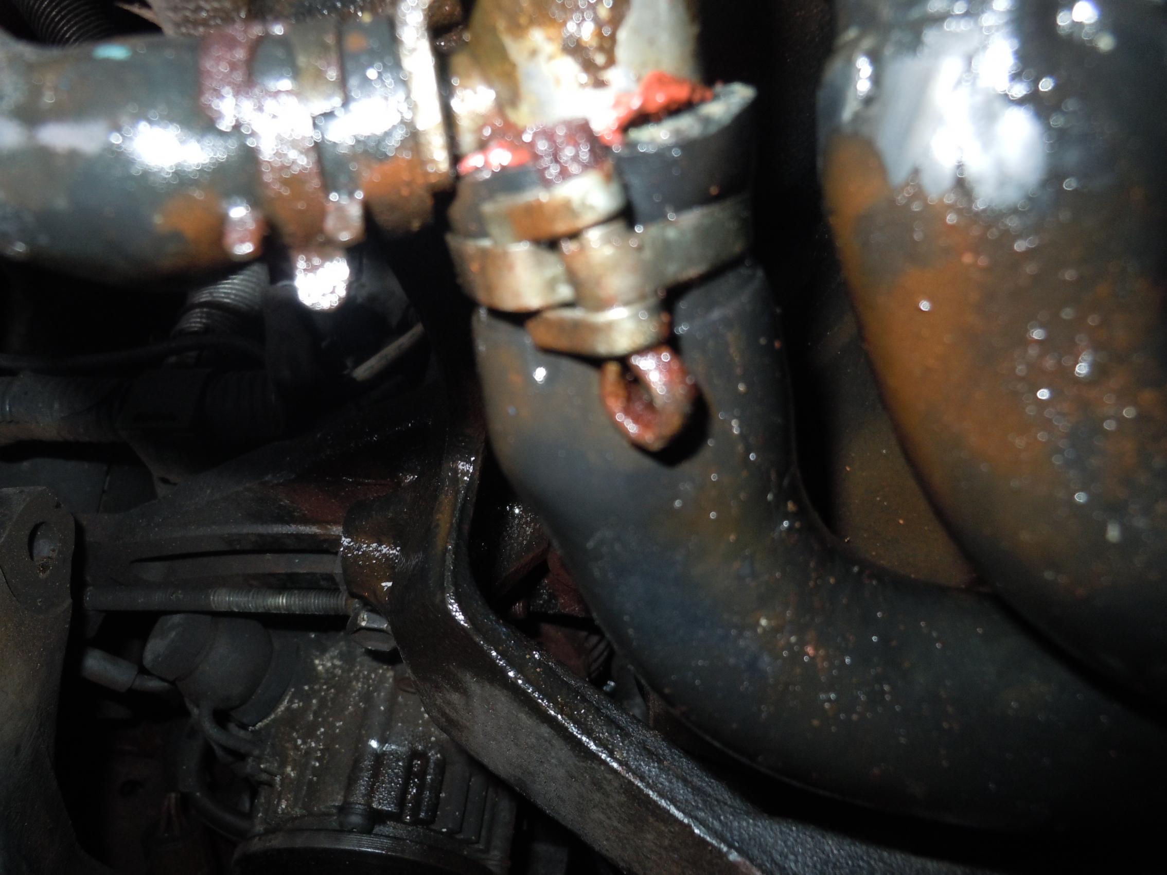

    WHAT YOU CANT SEE IS THE 10MM HOLE ON THE OTHER SIDE FROM THE LAST OWNER HAD DONE A REALLY RUBBISH WELD

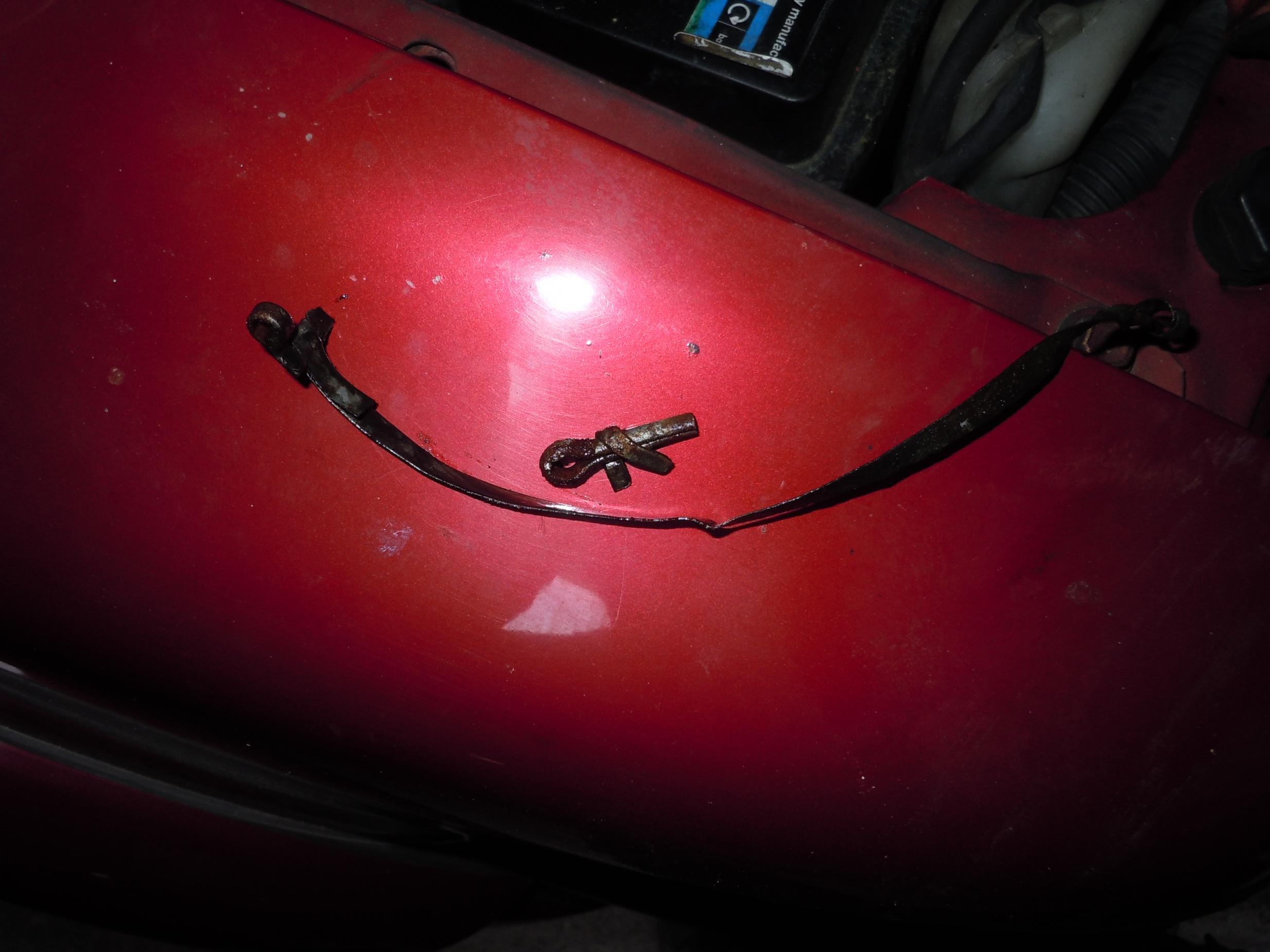

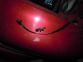

    NEXT ON MY AGENDA WAS TAKING OF 12+ OF THESE HORRIBLE SPLIT PIN CLIPS
    SO I JUST CUT THEM OFF

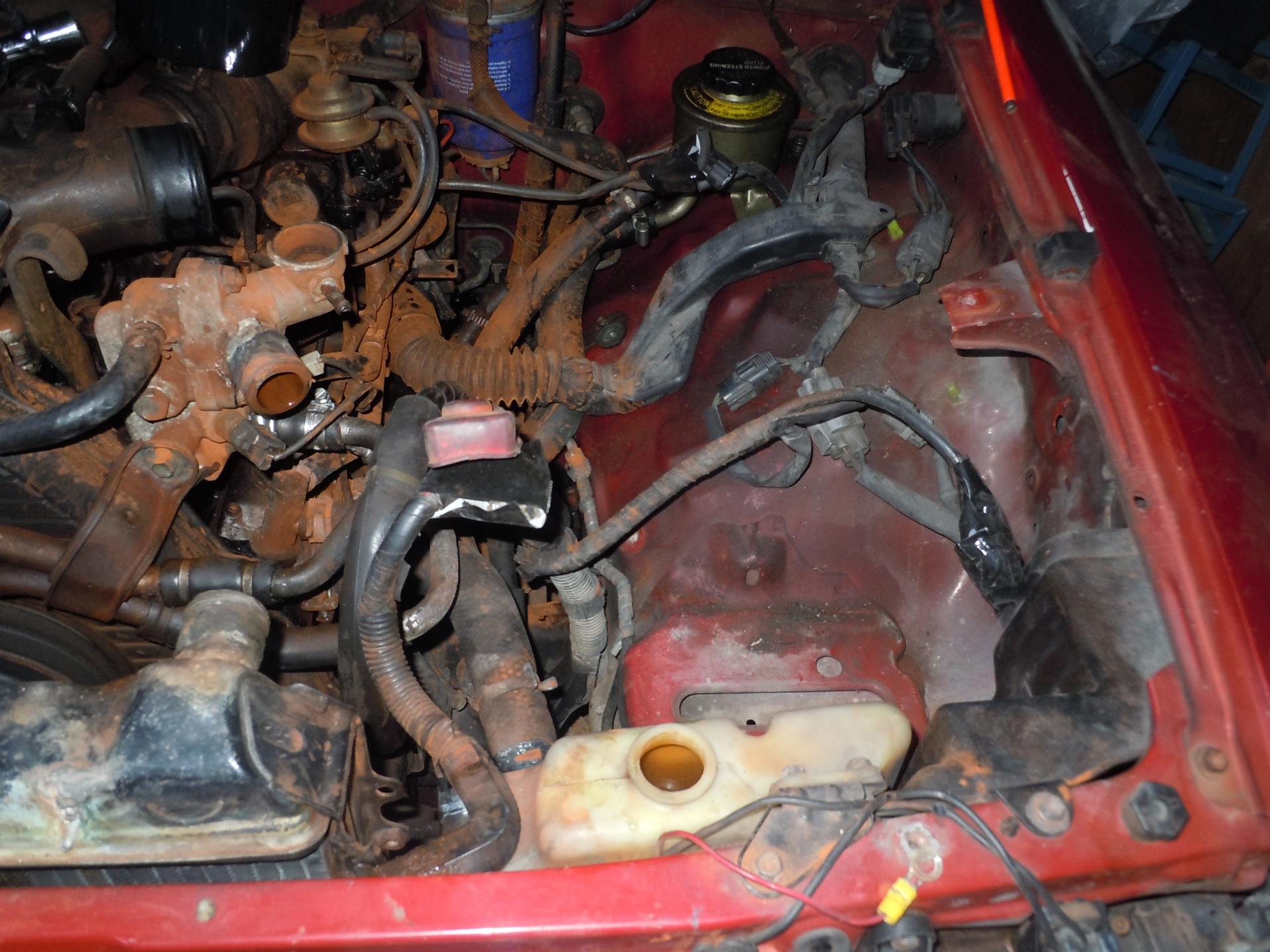

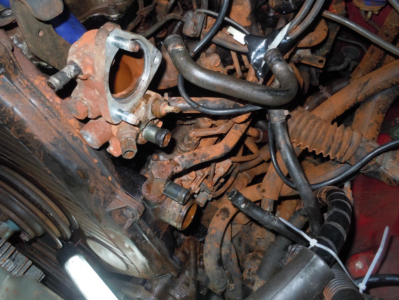

    NEXT THE THERMOSTAT HAD TO TAKE IT OUT OF ITS HOUSING WITH A SCREWDRIVER AWELL

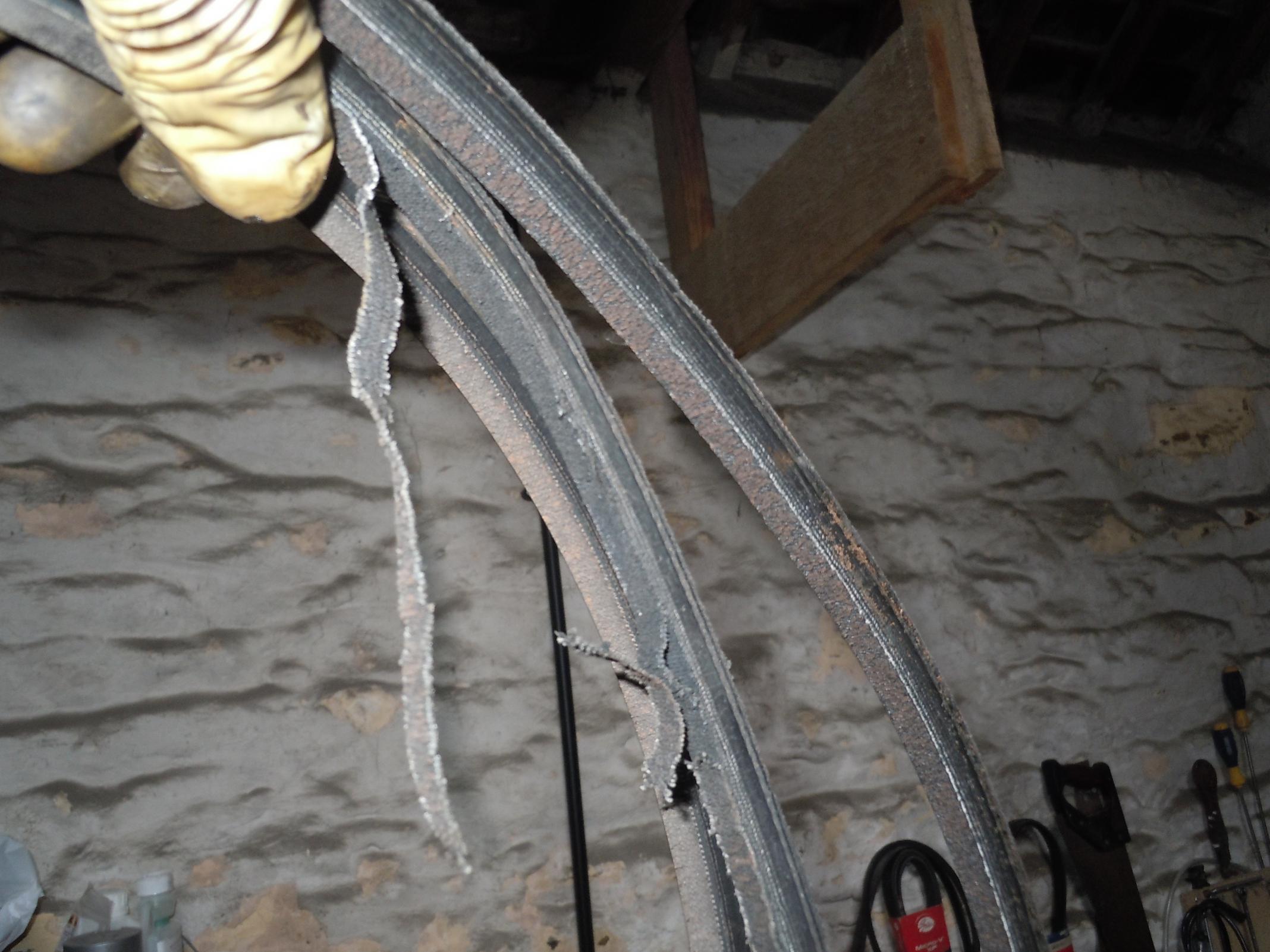

    THOUGHT WHILST IM HERE ILL CHANGE THE BELTS
    WHEN I WORKED OUT WHICH WAY THE TENSIONER WENT
    OH DEAR......YEP DEFFINATELY NEED CHANGING

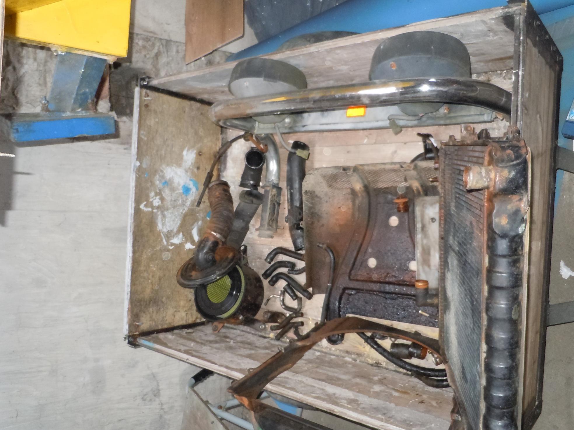

    AND THIS IS THE RESULT AT THE END OF DAY 1
    ANYONE FOR PARTS LOL

      You've forgotten to buy a new cylinder head, timing belt, idler and tensioner.
        Can someone resize the pics?
        Nev
          High performance silicone hosing? Magic stuff hey? Anyway, you also forgot the Crank and Cam seals as well.
          Nev
