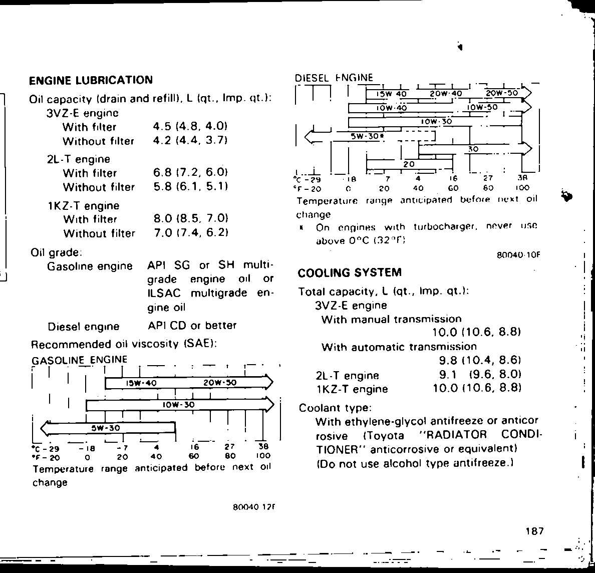

                      To obtain the correct oil level its better to check it after its been stood up for several hours, do it in the morning after its been standing all night. This will allow the oil to run off the engine walls and settle in the sump so you get an absolute level reading.
                      It can be as detrimental to engine operation if your oil level is too high and this should be avoided as is too low an oil level.
                      I have attached the toyota oil specs from the manual to give you the correct oil
                      data.
                          data.
