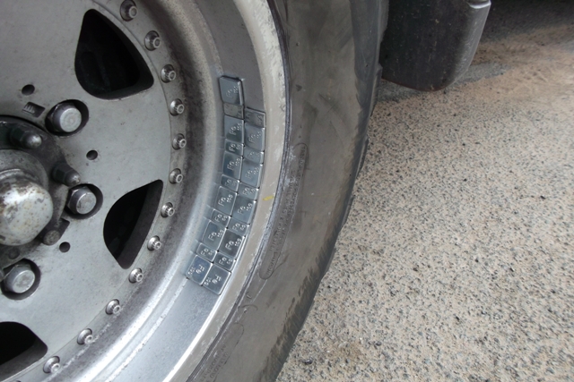

                    I got a full set of Camac 255/75 15 for free. had them put on the truck and balanced. I'm not sure if they are very low quality but I now have 175g and 165g of weights stuck to the front of my alloys. It seem a bit excessive, has anyone had the same problem ?
                        I had that problem, turned out to be the rim.
                          Is it possible to have the wheels balanced (without tyres) ???
                          All the best
                            Why? You can't drive on a wheel without a tire, so what are you looking to accomplish? You could spin it on the machine and look for runout/bends if that is what you're asking.
                              I suppose I could (in theory) find out if it was the wheel or the tyre that was out of balance(or both) and ( in theory) see if it was possible to offset some of the in-balance by rotating the tyre on the wheel (in theory).
