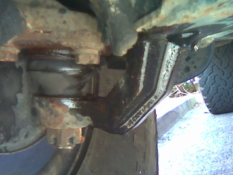

                      Success !
                      I've got a good picture of the part I've been referring to, but I don't know how to upload a photo on this site. All I can find is a way to reference a photo that's online.
                      I'll upload the picture if someone tells me how.
                      However, the spray grease has worked. It took a 20 hours or so but the squeaking is gone. Ahhhhhhh
                      If in doubt "grease everything that moves!" Worked a treat!
                      I think I'll grease all the moving parts at the back too!
                      Thanks, Peeps
                        Click on Manage Attachments in the Additional Options section below the reply section. Choose the photo on your computer and then click upload.
                        Nev
                          Sounds like upper control arm bushings from the description, but a picture is worth a thousand words.
                          '96 Toyota Hilux Surf SSR-G - RIP
                            Here's the picture.
                            The part that looks extra dark and dripping with grease was the part that was squeaking from the wider wishbone side joints.
                            It's like a little arm at the end of the wishbone.
                              Thats a lower ball joint, if its squeaking it needs changing ASAP, at least grease it properly, spraying it won't do it much good.
                              If it fails you'll be in a world of shite
