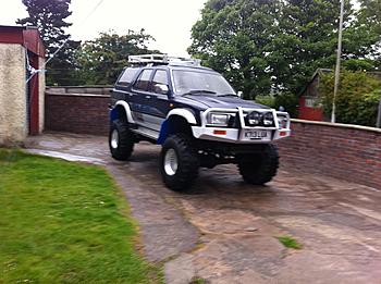

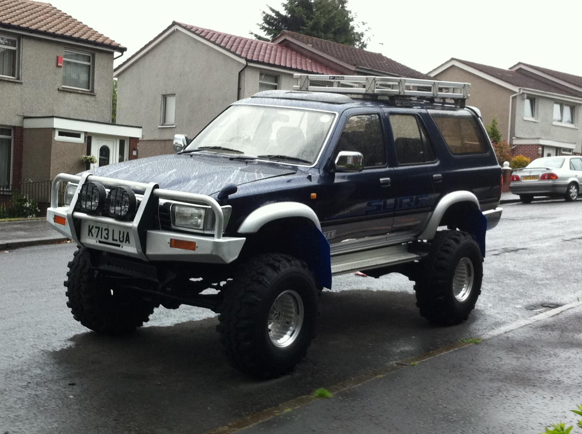

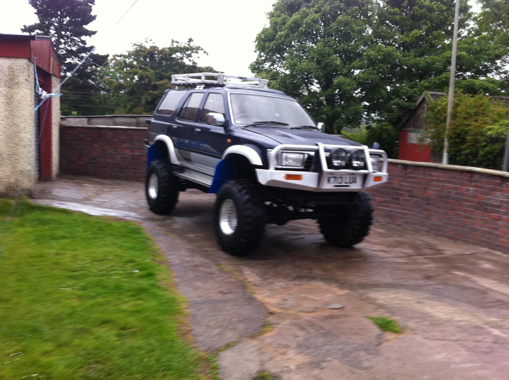

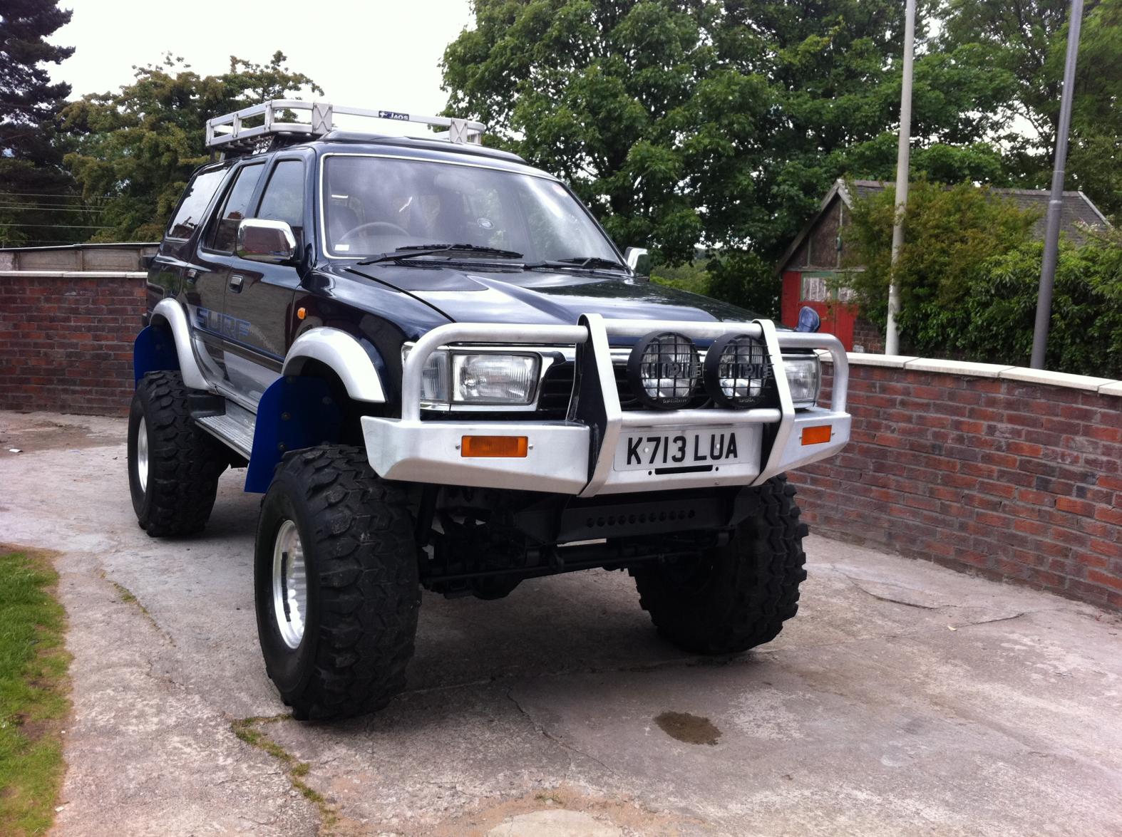

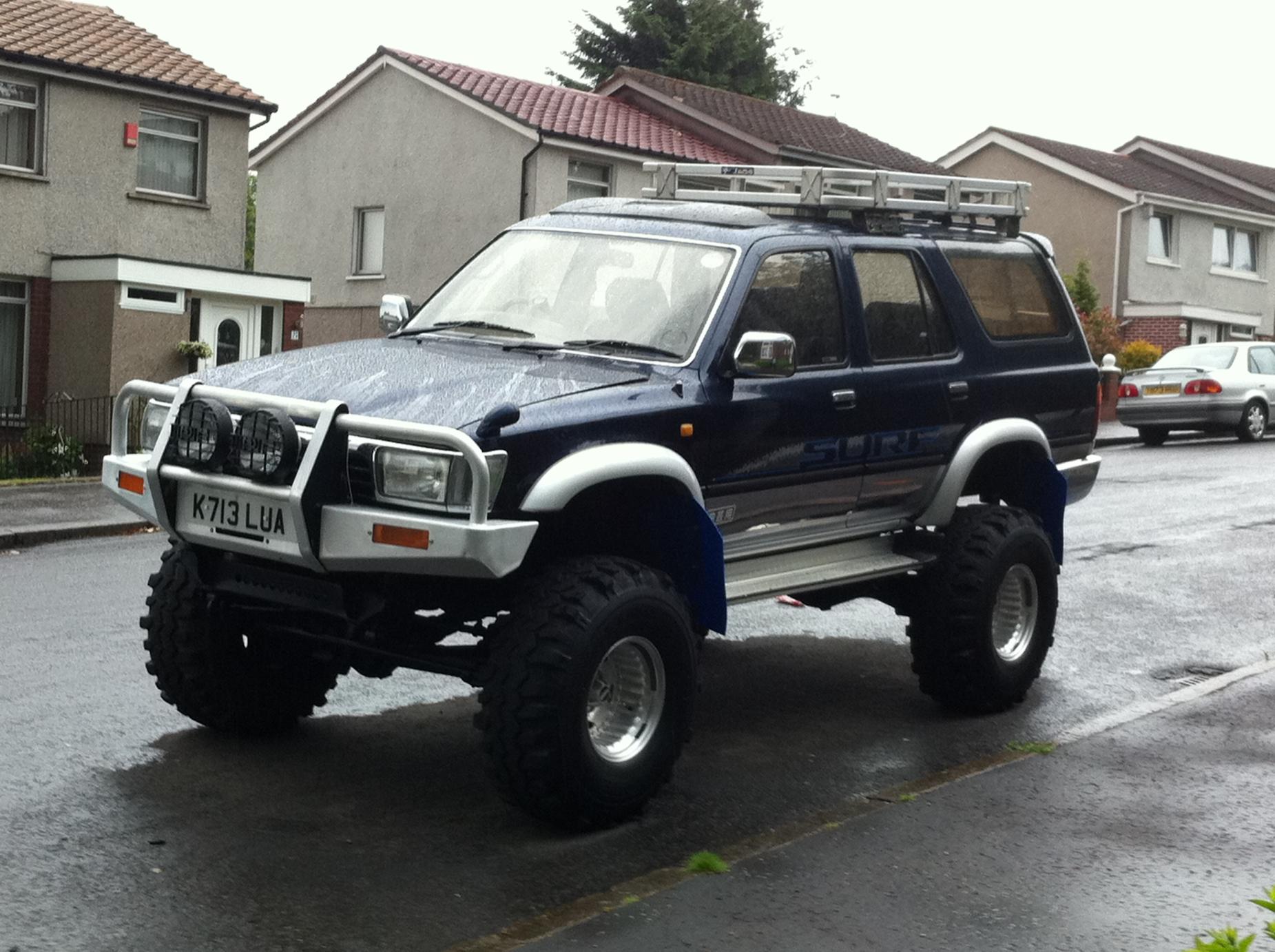

      Hi, when you mean have it on, do you mean that the dash light should say OD OFF or should there be nothing on the dash? Thats what confusing me. Good to be on this site, just got my surf love it to bits. some pictures for you.
