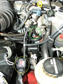

                  It'll be the short rubber pipe in the green circle in the photo below, thats come off. .......

                      Checked the pipe Bushwacker suggested, its still attached but that whole area is very oily, there is a pipe of similar size beneath it that is very oily. Any other suggestions............please.

                        Could be to boost pressure sensor. (circled in yellow)
                        Pull the pipe off of it, bend it in half and wrap some tape or a cable tie around it to keep it sealed.
                        Go for a test drive and if the symptoms are the same then the sensor is faulty.
                        Is everything else connected as in the photo?
                          I don't know the 2.4 well but I had the same problem on my 3.0 when the turbo pressure sensor pipe had come off.

                            I have not had a chance to try the sensor yet, but where could I find a diagram of the hoses to make sure all are connected and to the correct place. Would be good if someone local to me who knows there Surf's could have a look.
