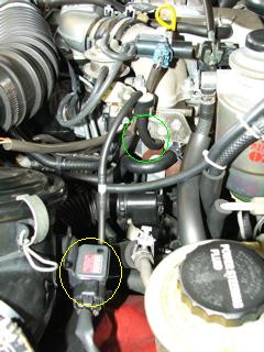

    Bolted to the side of the airfilter can is the boost pressure sensor, make sure the vacuum pipes to and from it are connected.

        There's a short piece of vac pipe on the side of the inlet manifold with a small filter/valve on the top, (it comes from the boost sensor) this pipe can get covered with oil that has condensed and dripped out of the inlet tubing. The oil causes the rubber to swell and can slip off.
        If this short 'J' shaped section of vac pipe isn't connected, you'll get no boost, even though the turbo is creating it.

            Stand at the passenger side, looking at the air filter housing, follow the rubber pipe from the boost sensor on the side of it to the inlet manifold. You'll see the small filter/valve clipped to the maniflod, the 'J' shaped section of pipe is under/connected to that.

                No worries, here's a photo to show what I'm on about...
                Circled in yellow is the boost sensor.
                Circled in green is the 'J' shaped boost pipe.

                  i understand now, will look in moring give her a spin around and see if any improvements, can you buy a replacement boost sensor? do they usually cause problems?
                    The boost sensors don't usually fail, it's the vac lines that cause problems.
