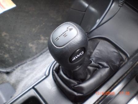

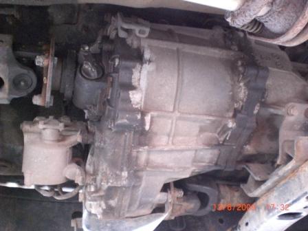

    There si nothing 'wrong' with the truck, you can get 3rd Gens without the multimode 4WD, it works the same as the 2nd Gen but isn't the same, as the front prop on 3rd Gens is on the other side to 2nd Gens so its not the same parts.
    its just a 3rd Gen with part time 4wd, not very common, but not anything 'iffy'
    Must be another one of them "it all depends on what the oringinal buyer specified", must admit, I've not heard of a third gen as late as a 98 without multimode on.

      A couple of pics:
      3rd gen 3.0 SSR-V '98 R

            don't drive it in 4wd unless on slippery/loose ground.
            Sorry for the uncertainty about your truck but i never realised that a 3rd gen that age would have the same trans as a 2nd gen

                  The guy I bought it from reckons he's a Surf expert, and I'd have no problem driving it in 4WD on any surface, saying it's the same transmission as the Prado's, and that I should ask Toyota if I don't believe him...whadya reckon ?
                  He's not, lol, he B/S'ed you, You can't use 4wd on the road.
                  All the Colorados i've seen are the same as the mulitmode 4wd Surfs, but without the 2wd option, no idea about the Prado's.
