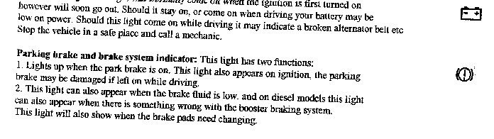

                Nev
                Dont shoot me I'm just the messenger! I wouldn't knowingly give out false info!
                read bottom line of the Japan New Zealand handbook! 89-93 models
                I have to say I am just as doubtfull about this feature as the rest of you!
                www.europa88.co.uk Loadsa mods!
                  Originally posted by europa88
                  Nev
                  I think your manual is incorrect.I have dismantled brakes and there is none there.I only have a 4Runner owners manual and it states that there is two warning lights.One for the hand brake and the other is a low fluid or vacuum warning.I am now wondering if my info is correct and if this is actually on the Surf.I will have a look in the morning.

                    It may be a translation error in the New Zealand handbook? I guess they are translated and reprinted in New Zealand!
                    I really cant recall seeing any wiring to the pads!
                    It must be a typo

                      You don't have to dismantle them, just look for the electrical wire and connector, mine has not got one but it sure is squealing, but still has a 1/8th of an inch left on the pad, will have to order some, wheres the best place, I want proper Toyota ones, I have learnt my lesson on after market pads, they are s--t

                          thanks guys, tracked it down to faulty level switch is brake fluid reserve....not sure about this brake warning for low level on pads though because i can not see any wiring to brake area..
