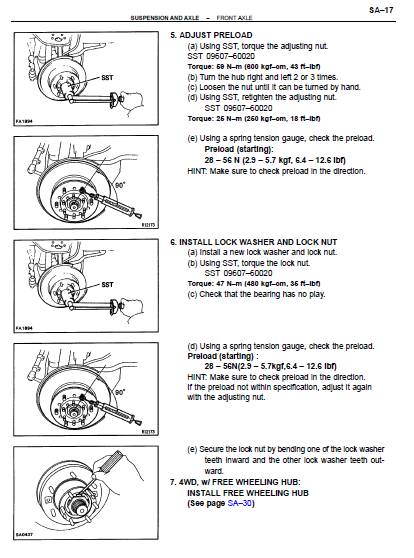

    The milners tech dep't said I shouldn't be using a socket anyhow.
    I'll stick to the method in the Toyota manual thankyou - they need to be tighter than you'd guess at by feel to get the preload correct.

    What the manual states:
