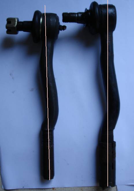

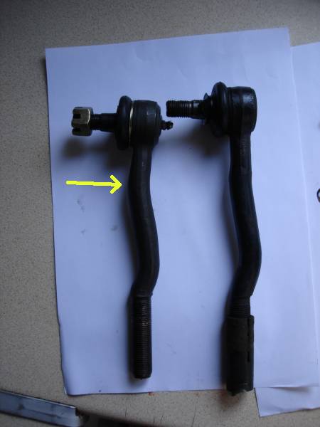

Just fitted my new drivers side inner and outer arms. Set up exactly the same length as the old ones (made a jig at work)

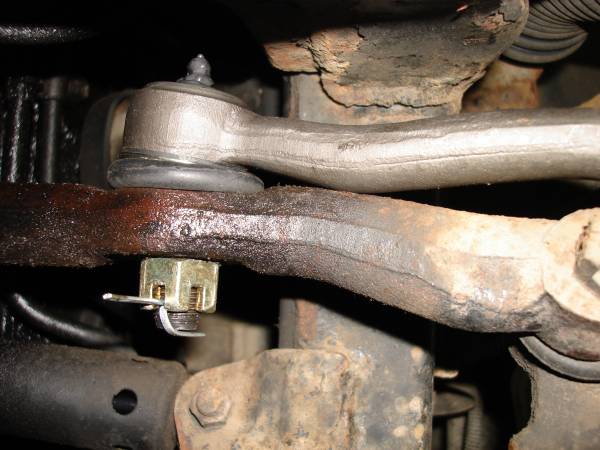

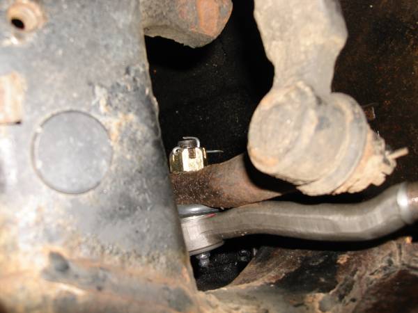

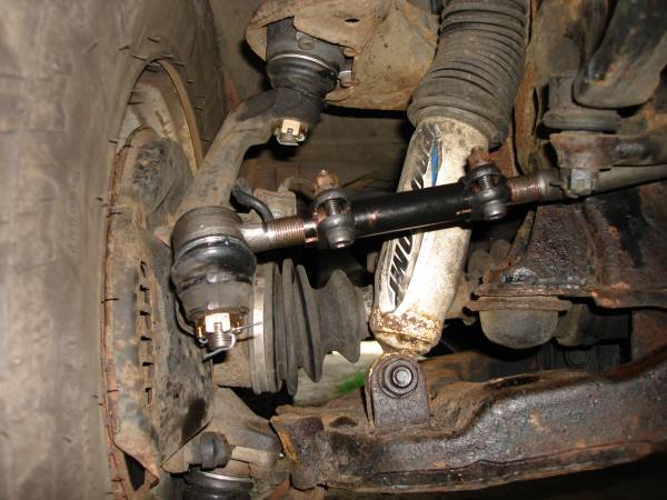

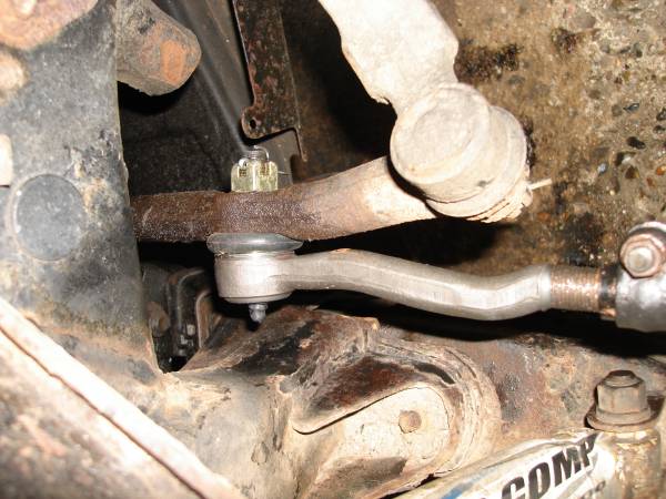

When fitted the inner end rubs against the long steering rod it is connected to..
Looks like the inner rod needs grinding to have clearance. No way am I grinding steering stuff.
Am phoning Roughtrax tomorrow morning as they were shut by the time I'd fitted it this evening.
Just wondered if I'm the only one this has happened to ?
