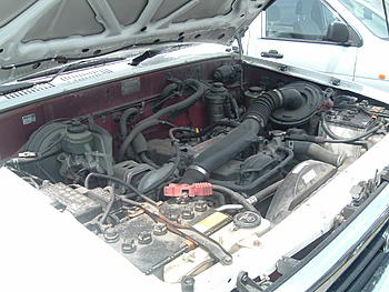

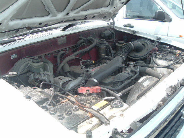

LOOK at the lift on this and see how LOW the engine is.!!!!

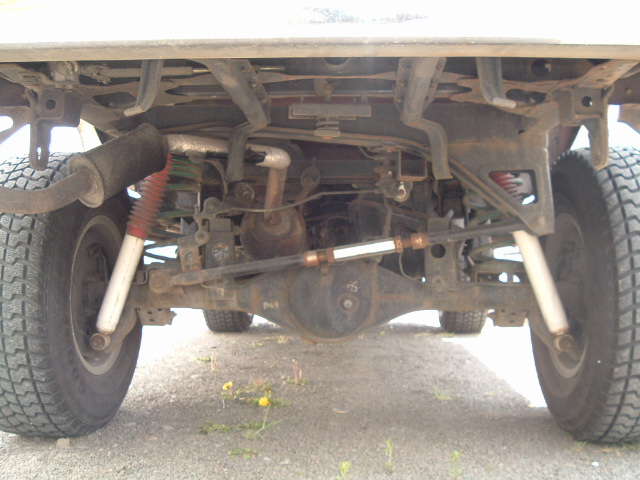

Nice adjustable Panhard rod . At least that keeps the wheels in the centre of the motor and not pulling them to the o/s like most lift kits do as they do not supply or even mention this prob .Originally posted by HiluxLOOK at the lift on this and see how LOW the engine is.!!!!
RickRick...Member of 1st Gen club. ONE LIFE ... GET ONE !!
The panhard rod needs to be as parrallel as possible, much better to lower the upper mount by the amount of lift, that will still get a lot of movement from side to side as the axle moves up and down, I'd be more interested if the 4 link bars are lengthened to put the axle back in the right place.
Its not really worth worring about on 2" springs IMHO, on bigger lift needs to be done.

I believe, but could be wrong, that it is the same specs as supplied with various US and Oz kits for lifts up to 4/5"Originally posted by AndyLalaAnd this panhard rod drop bracket will support how much of a lift?
andyLwww.europa88.co.uk Loadsa mods!
