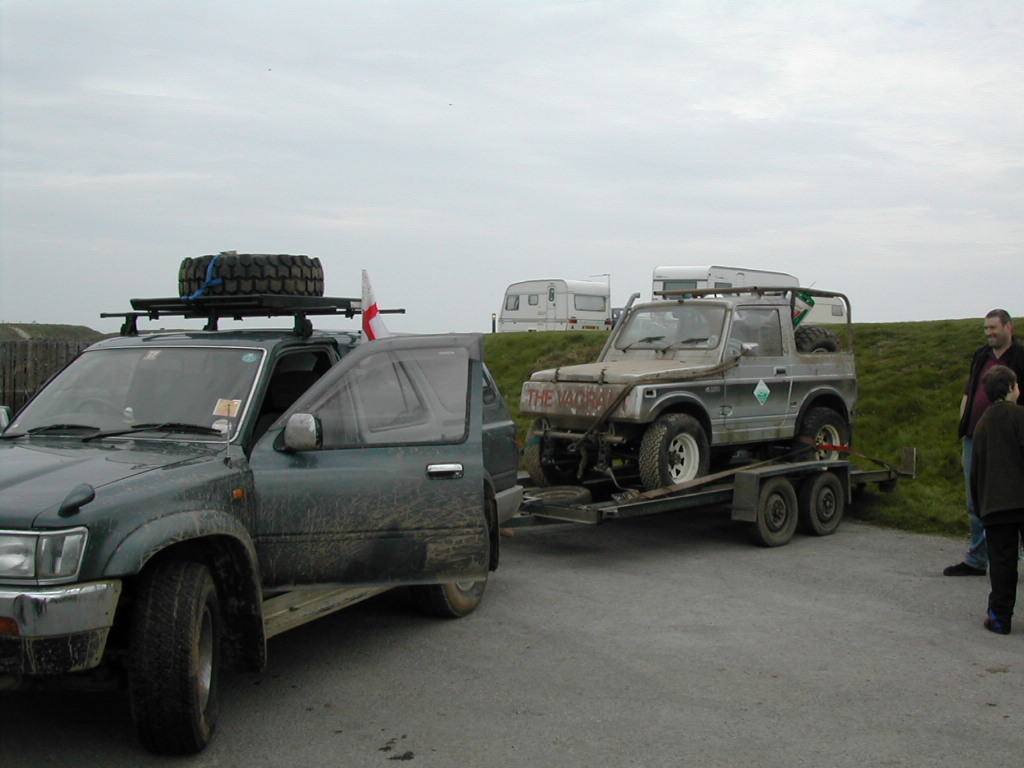

                          You will have no problems towing I just towed this on a 500 mile round trip
