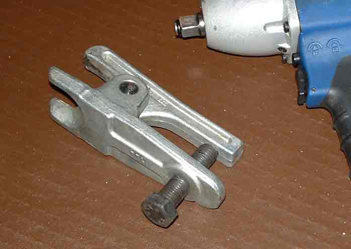

The best bit is by the time I'd got home I'd spent a £100 quid at halfords buying tools, grease etc to do the job myself...by 4.30 I'd spent another £100 quid on x2 upper & x2 Lower ball joints, Idler steering bushes and a Filter Kit from Milners(Thank the lord for Milners)
Now I'm itching to get the job sorted...as soon as he parts arrive.
Does anyone have any advise on replacing the ball joints? I remeber someone mention grease nipples?
