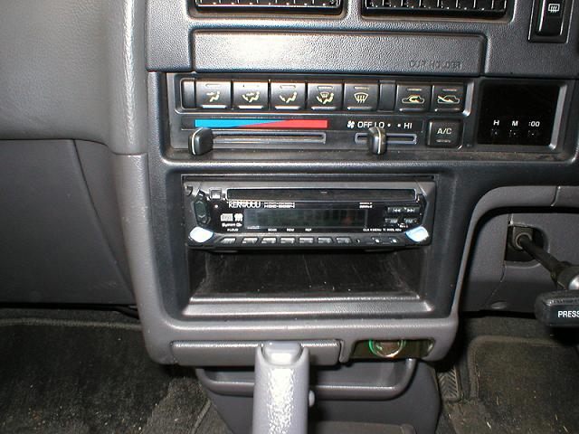

        search for double din on ebay, i use a single unit with the halfrauds cubby box, it looks ok, but not as neat as the double din i took out. Use the wiring harness adapter (if your radio wiring plugs have not been cut) again from halfrauds, most toyotas from this era use the same adapter.

          that is correct, but if you have an amp fitted at the back of the radio, i think they come as standard on the ssr-g, a different one is required and its £30 instead of £10, its the one which fits the toyota mr2 as they have the same set-up

            Bin the double din, go for a single - fit the box - you know it makes sense
