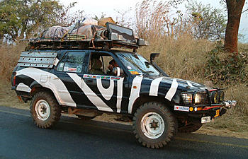

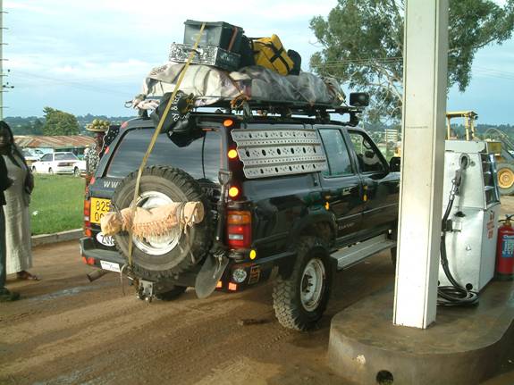

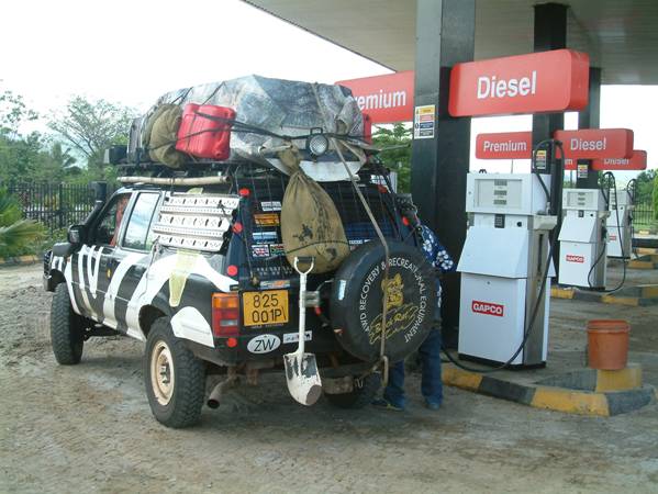

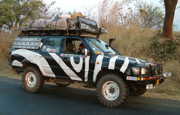

                The first pic was on the road to Nairobi Jan '95 and this one was on the way back in '96. This time we weighed in at 3010kg - 500kg over GVM! WE only managed this with the HD Old Man Emu setup and Mich XZLs at 40psi.

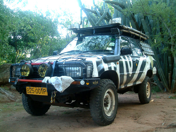

                  And there is that mad paintjob... fantastic...
                    Mad paint job? What me?
                    @africa4x4cafe
                    [url]www.africa4x4cafe.com[/url]
                      that is rather special...
                      with a rather bald front tyre...

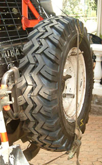

                        Yes, we did do ALOT of driving in Africa...however, I then replaced the Mich XZLs for Firestone Stallions (750/16) when I started getting bogged alot off road.

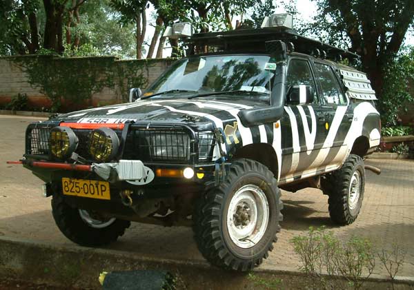

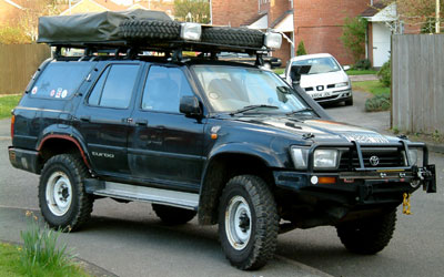

                          To get back to the OP's question - sort of...here is a pic of my truck before we shipped it to Efrika. You can see two Michelin XZLs mounted up front on the roofrack and the RoofTopTent mounted to the rear. It opened to the rear as well - giving shade when you have to work/cook on the back door.
