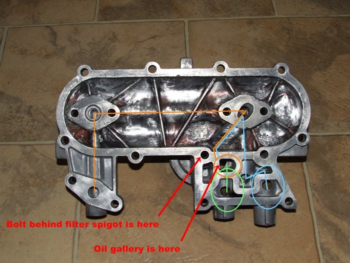

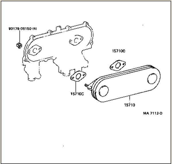

Thru the postings on the site I came to a probable issue around the Oil Cooler.
I Stripped down that side of the block and got to the point of the getting the Oil Filter Adapter off.
The machine shop did up the block for me. They took the Oil Cooler off and put it back on.
BUT they did not reinstall the bolt under the Oil Filter Adapter.
Is this paticular bolt enough to cause major oil loss into the Cooling system???
I have lost about 2-3 liters, have been trying to flush out the cooling system but no luck, it just keeps coming,,,
( major bummer specially since I got a new rad and had the whole cooling system squeeky clean before fire up LOL oh well)
As the engine is fresh I have not entertained the head gasket as a cause for the oil in the coolant.
Also wonder if the timing belt housing gasket could also be a possible source if this oil cooler bolt thing does not solve the problem??
Thanks for all the help it has been invaluable to getting this beasty up and running.
