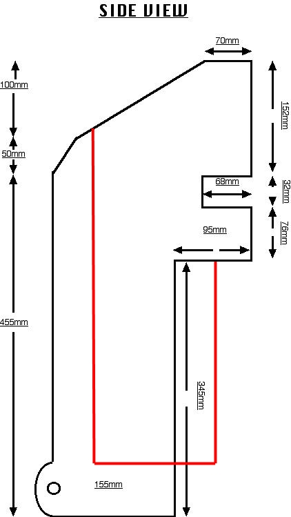

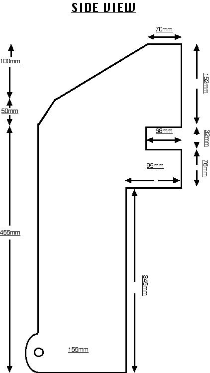

                      First pic is what I had laser cut for my rear bar.
                      Second is what is roughly has to be done for a rear bar with 50mm body lift and a box section for rear. Bottom of bracket is shortened at least 50mm and top is increased 50mm. End is shortened around 75mm because of the difference in my bar design. Make any sense? Final measurements will need to be done so I suggest a template made and then go from there.

                        Cheers neville theyre brilliant, im startin work right away.
