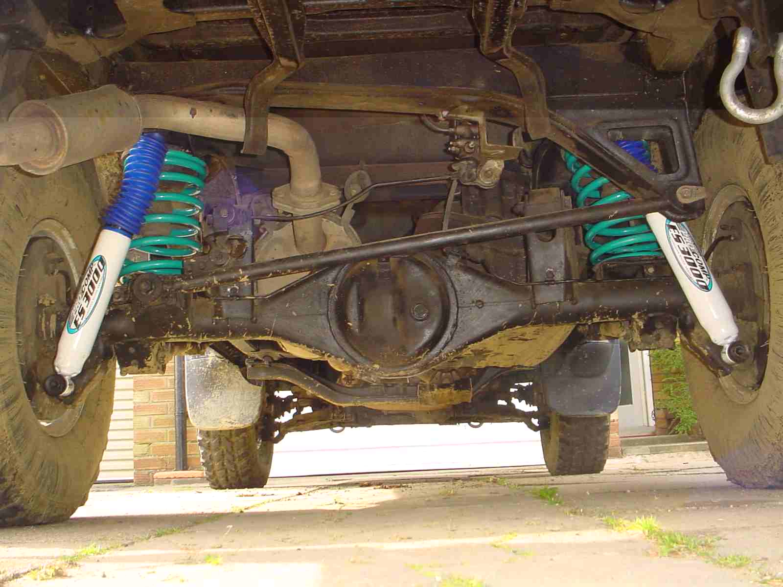

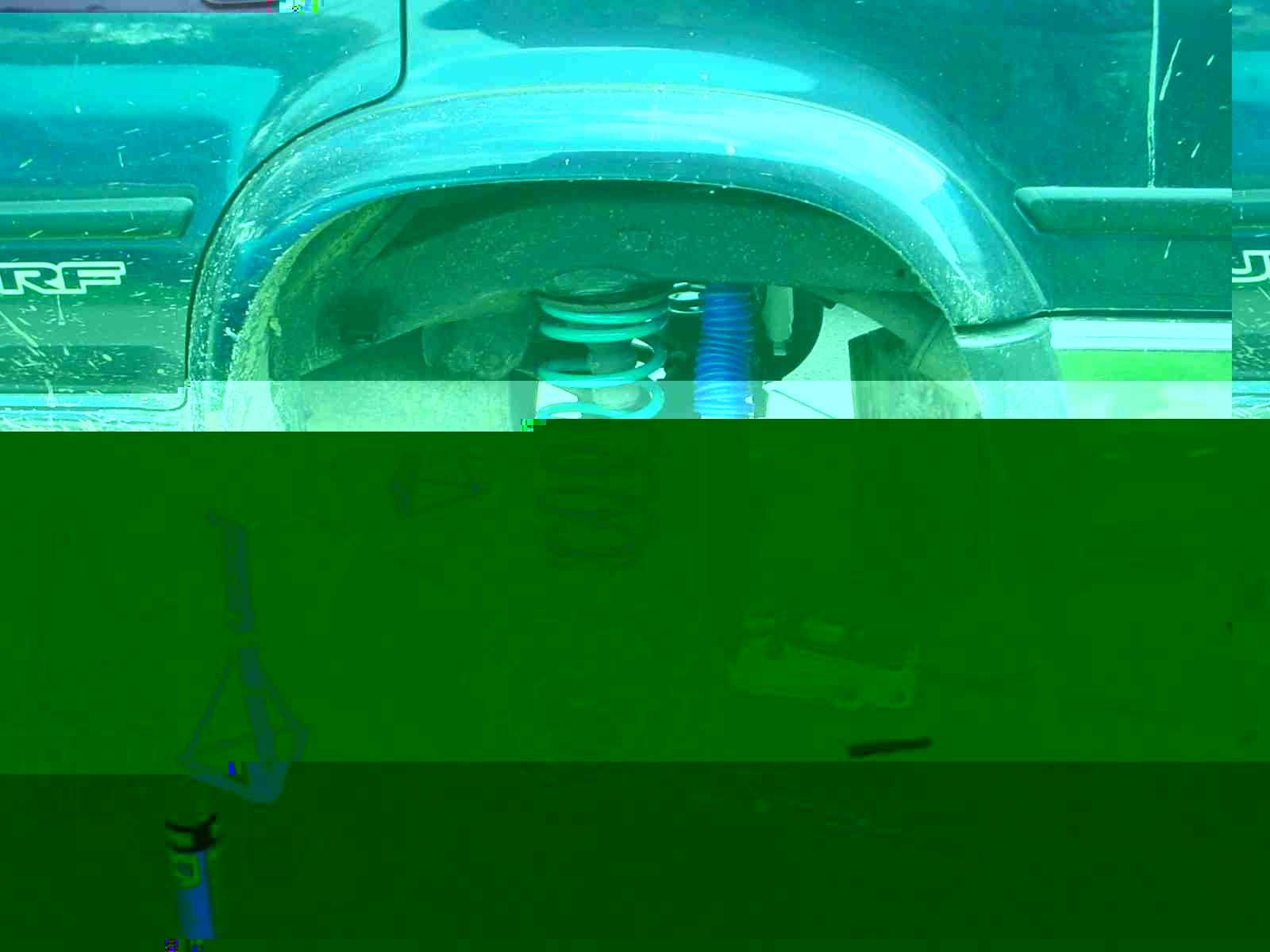

            Looking at your pics I noticed that you don't seem to have a gap between your rear chassis legs and the floor pan. I do (of about 1 1/2 inches)... does this mean I've been lifted and didn't even know it ?

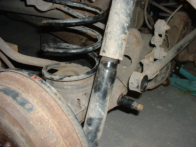

              here are some pics for you

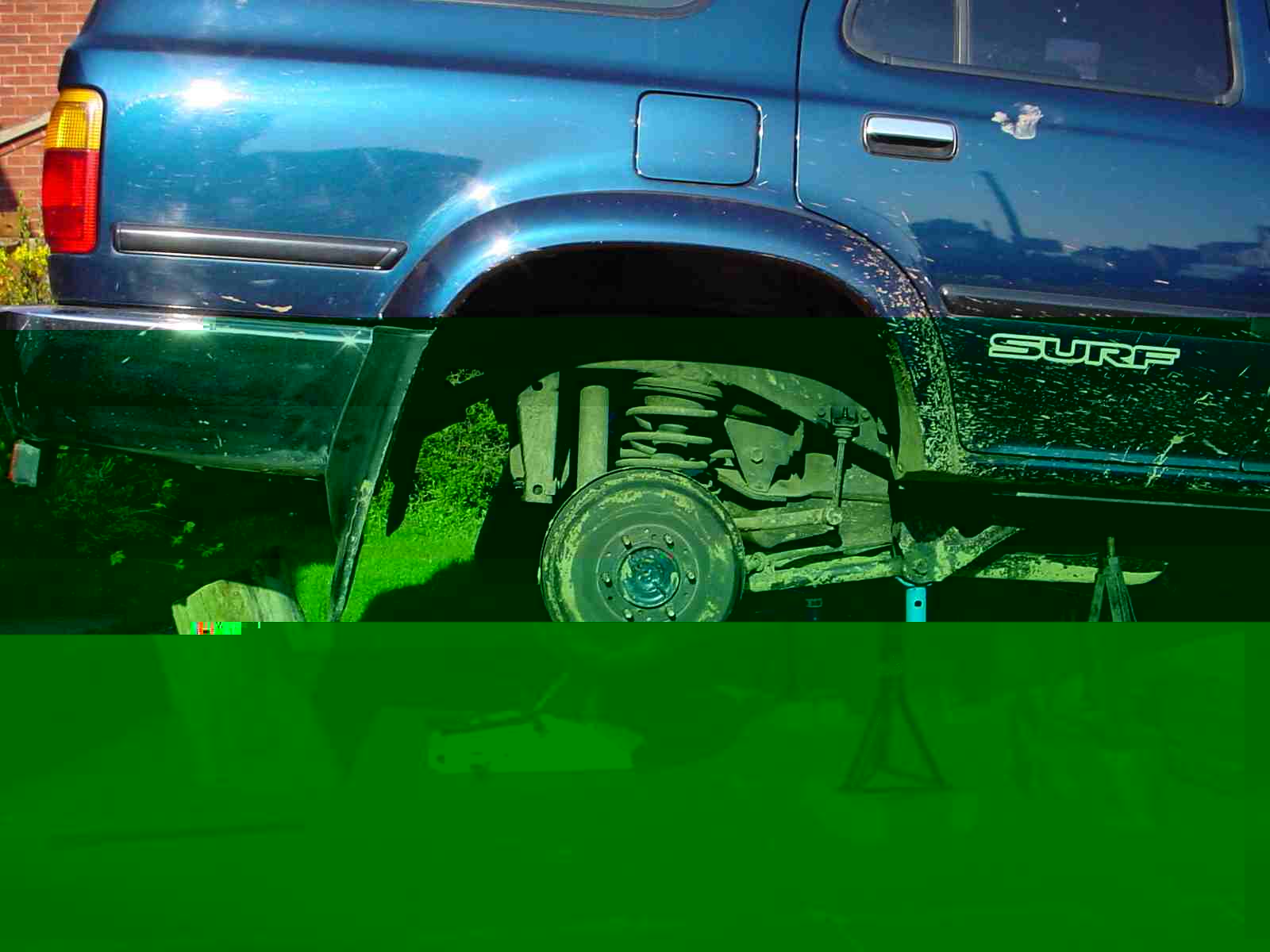

              heres a few pics of my 4runner with the rear axle lowered. take the bolt off the brakeline t peice to allow the axle to lower all the way.
              may as well remove lower panhard bolt, both lower shock bolts and possibly even anti roll bar side bolts if you need it
              prepare yourself with a good selection of jacks, axle stands and bars to get the axle down then up again
