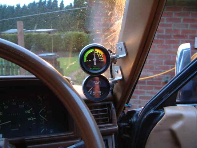

    anyone know how / where a turbo boost gauge plumbs / wires in?
    i looked at one today and it only appeared to have 2 wires coming out the back, and the fella in the shop didn't have a clue!...
    Not a total expert on these things but wires are not going to help a lot.
    Mine has, and most will have, a hose/tube of about 2.5mm ID.
    Exactly where you fit a tee joint in the sense lines is a matter of intense discussion.
    I have plumbed mine into the wastegate servo line as this gives me a true indication of what the little steel snail is doing.
    While I was at it I have upped the boost and now it runs a bit better, more go juice but still better.

      I have one
      Mine came with a boost gauge, it lights up all nice and blue neon etc. Only snag is that it has never registered anything! The wiring looks like a simple power supply for the gauge lighting, as the needle is controlled by the turbo sucking air.
      It lights up so I assume that the connections are ok, and the tubing was plumbed in through a T-joint, but zilch on the gauge so I disconnected it.
      Of course, it could be that I have an air leak somewere, or a knackered turbo, which might explain a lot!

        the wiring is only for illumination you should find supplied with the gauge tubing adapters t-piece.. mine is plumbed into the small pipe that goes into the base of the inlet manifold
