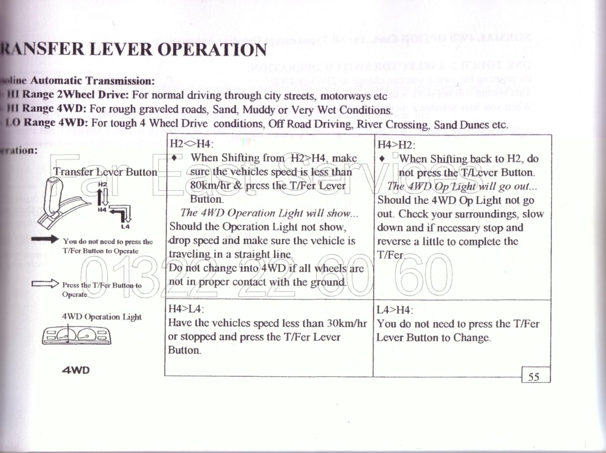

My surf has an auto box. I know that on the move I can change to 4WD by the press of a button.
What should I have selected on the auto box to go from H4 to L4?
Should you have it in drive before selecting the L4 or something different?
I was checking out the selection whilst stationery and had some amount of cog crunching going on when selecting L4. I believe I had the auto box set in neutral. Also whilst in L4, when I pushed the autobox into Park, I had an indicator come up on the dash with the characters AT/P. I presume this means Automatic Transmission Park. This does not normally occur in 2WD.
