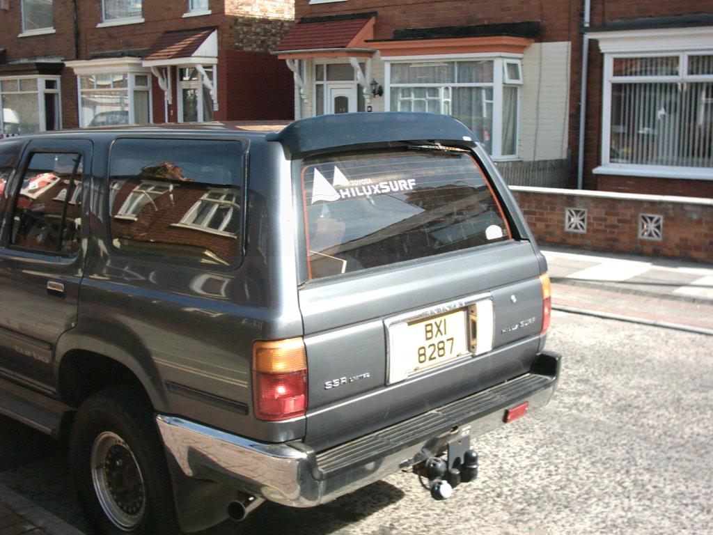

      Here is a picture
        Originally posted by lucky
        Yep off a 1990 Honda integra, lights and mountings bought from the scrapper for a tenner. You can get them off most Hondas and some Toyotas and Hyundais etc. Basically a lot of Japanses cars are built without them for the home market and they just use these flush mounted lamps and cut the bumper.
        All you gotta do is be brave and attack the rear bumper with an angle grinder to cut out the holes and the whole unt mounts straight in. I cut my holes for them slightly small so I don't even need a bracket to hold them in as they fit so tight.
        Here is a picture
        nice job that lucky.

          Mine was donated by a Rav4
            Looks good that, in fact I like it more than mine - might see if I can go and attack a Rav for one (or rather 2 ravs for 2).
