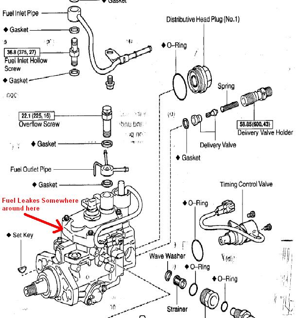

      i dont have an exact pic but i can post a pic that i found it on the net. I think it does leak from the joint between the top cover and the main pump body.
      Today i drove my surf totally 200 Km of road. But i didnt saw any fuel leaking when i stop. only i have saw early in the morning when i first start the engine.

          Sounds more like an expansion issue - when your engine is cold the gasket is probably shrinking very very slightly thus allowing fuel to seep out - Koi's suggestion is a good one - dismantle it all and refit a new gasket and see if that stops the leak

              Hi just had the same problem with my 2.4 surf and had to have the fuel pump reconned (£124.00) it was the cold start lever seal which had gone hard and the top gasket of the pump ,absolutely bucketed it out when it was cold but not a drop when it was warm , hope this helps

                As i mention before, here, in the place that i live in nothern Cyprus, there isnt toyota authorized service. And other services dont understand these japanese vehicle well. At last i went to mechanic in the southern cyprus and he found out that there is a small hole in one of the fuel pipe that going in the fuel pump. that was my problem. he fix it and now there isnt any fuel lekaing. But i dont know why it was leaking only when the engine is hot.
